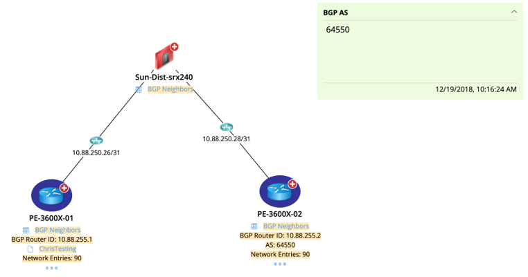

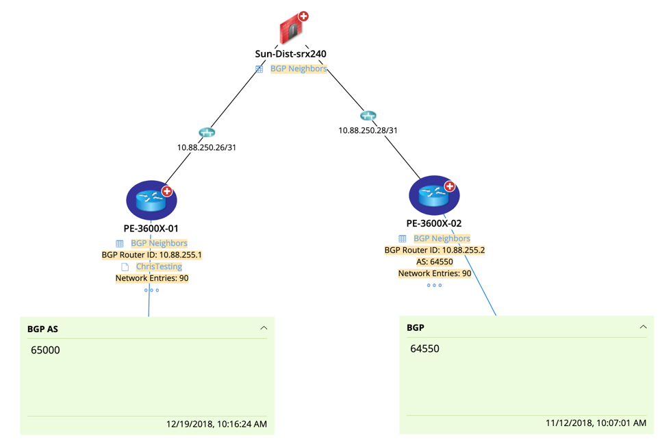

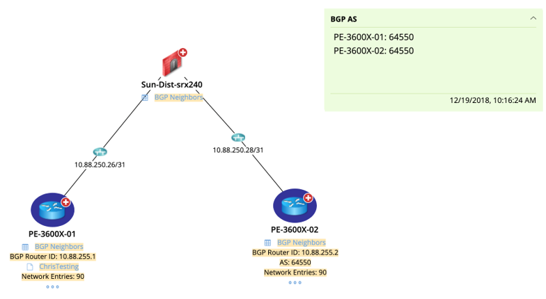

Set a condition to control when this device note will be displayed on a map. ▪The default value - Always, indicating this note will be displayed under any circumstances. ▪If you select an option variable as a condition, then the note will be only displayed when the value of the selected variable is: oNon-empty (for string type) oNot equal to 0 (for number type) oequal to true (for boolean type) Note: Both device-level variables and input variables in the supporting variable list of the current data view template can be selected to define the display conditions for device notes. |
Display Option |
Set a display mode for the device note for all qualified devices on a map. ▪Individual Device Note — a note linked to one device. Each qualified device displays its own device note. ▪Compound Note (Append) — a note linked to multiple devices and its content is merged with the notes of these devices. Each note uses the hostname of the device as its prefix. ▪Compound Note (Overwrite) — a note linked to multiple devices but its content is the latest note for one device. The previous note will be overwritten by a new one. |
