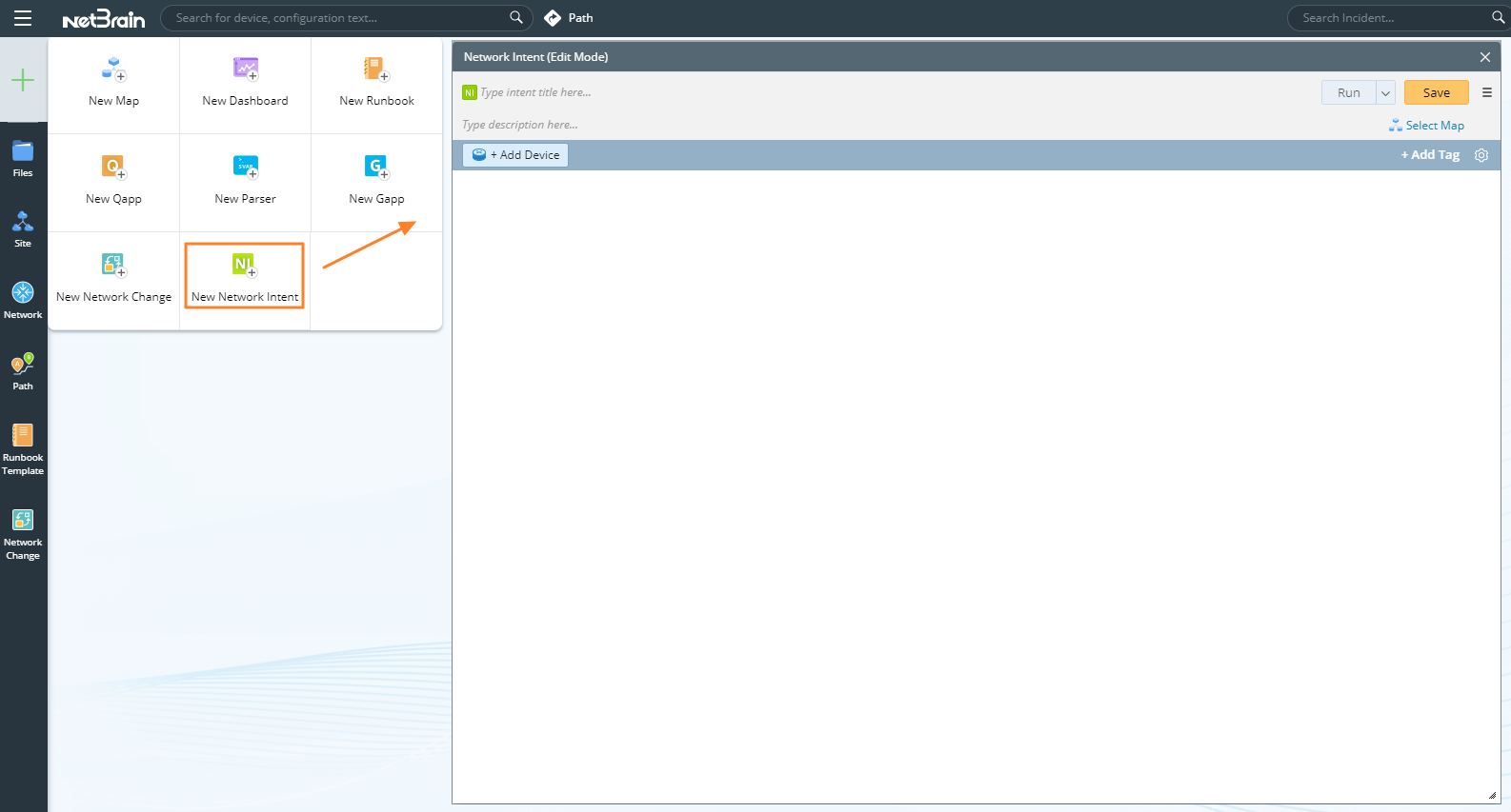

1.Click the
icon and select New Network Intent.
2.Enter an NI name and add the following components.

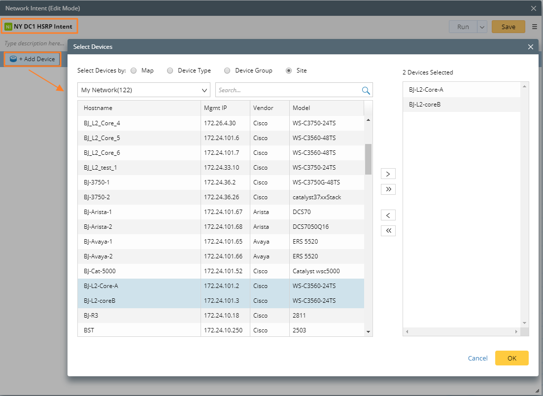

1)Click Add Device to add the target devices. In this case, devices are added by site. You can also add by map, device type, or device group.

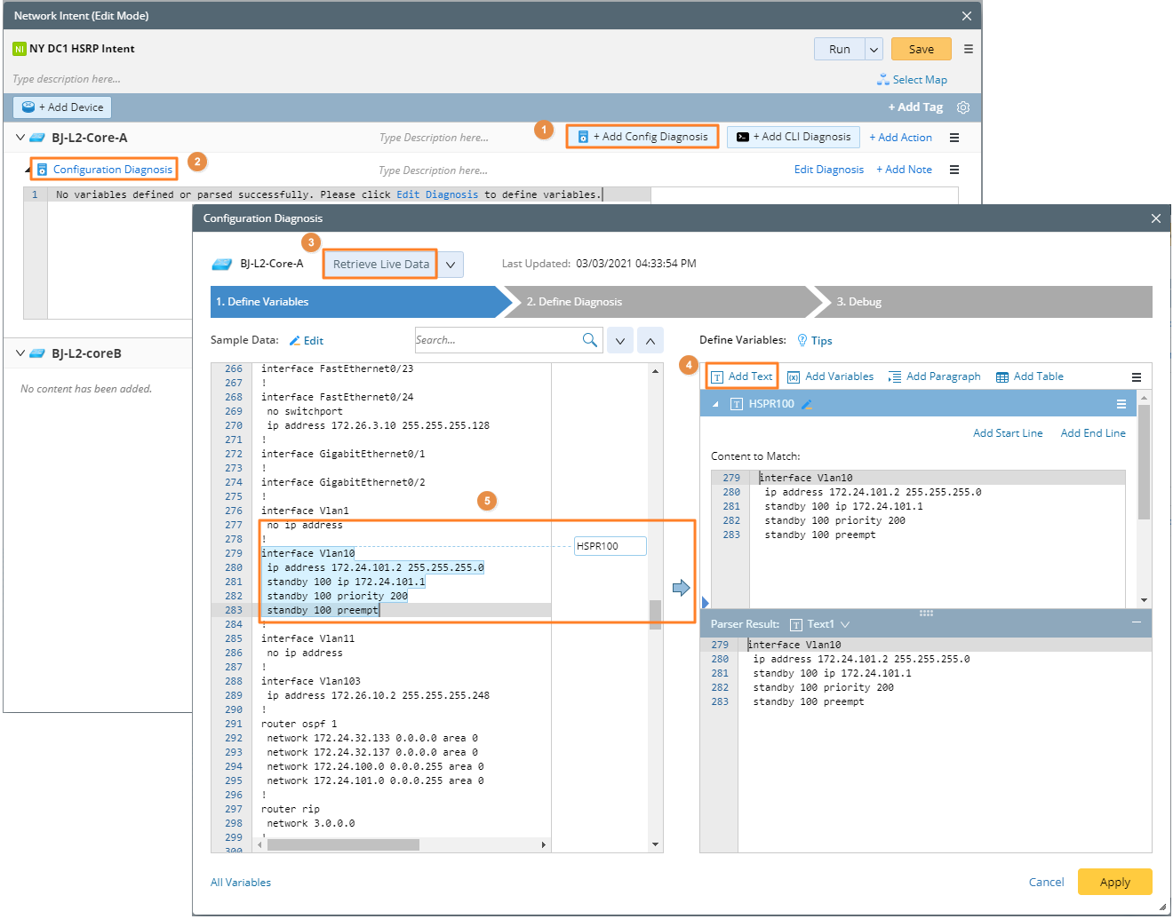

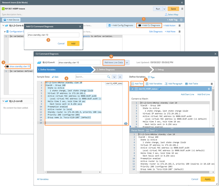

2)Click Add Config Diagnosis and Add CLI Diagnosis to add the Config and CLI commands related to this NI. See adding config and CLI commands to NI for more details
3)Define parser for Config and CLI commands. See defining multiple types variables via visual parser for more details.

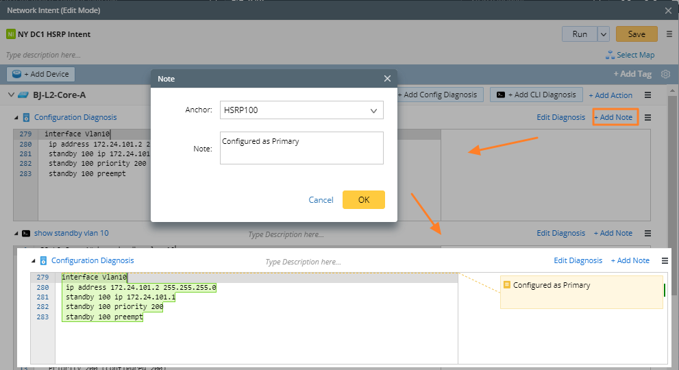

4)Add note,diagnosis and status code to this NI.
