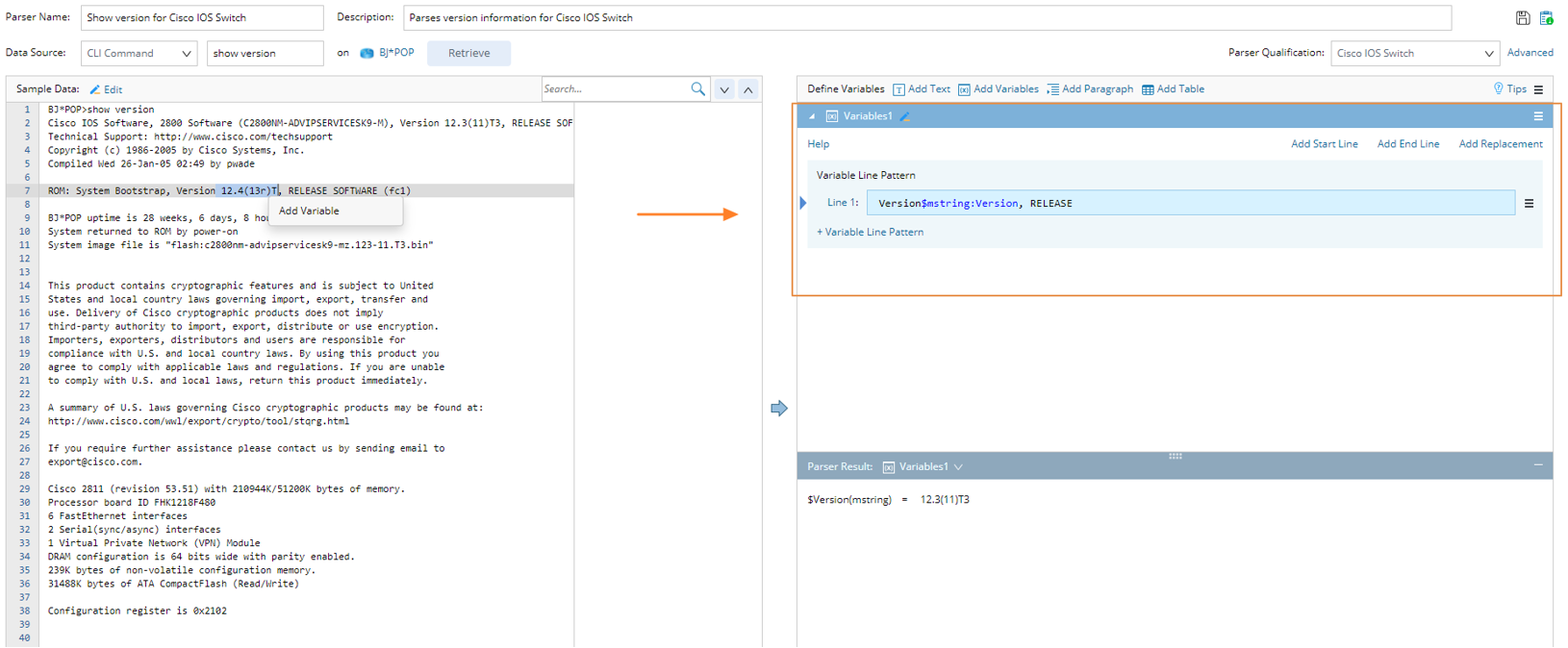

Defining a Simple Variable Parser to Parse Version Number
Take the parser of version number for example. You can define a simple variable parser to parse version numbers.
1.Retrieve sample text.
2.In the Sample area, select the value of version number 12.3(11)T3 and click Add Variable in the context menu.
Tip: You can also select the line of text in the Sample area and click the arrow ()  to duplicate it as the Variable Line Pattern.
Tip: The system uses the two words before and after 12.3(11)T3 as keywords to automatically generate the line pattern Version $version, RELEASE, using the notional word closest to the variable as the variable name (version in this example). If the word before or after the variable is “is”, “was”, “on”, “of”, “with”, “at”, “under”, “for”, “in”, or “:”, the system will look for one word further.
3.Edit the Variable Line Pattern if required. For example, rename the variable.
4.To define more variables inside the keyword parser, repeat the above steps.
5.Preview the parsed result of sample text, and click OK to save the keyword parser.
