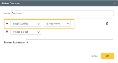

2.At the Output node, define conditions for the Qapp to execute the subsequent actions. In this case, define a condition to check that a device is configured with OSPF.
Select $ospf_config in a drop-down list and then select is not None.

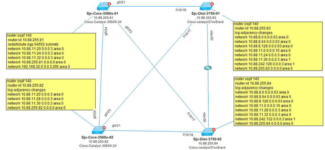

1)Keep the Highlight Device option as default. The $_device variable in the Device field refers to the devices you will draw on the map.
2)In the Legend field, type a legend content. For example, enter "OSPF Config".
5.Extent a Draw Note action node from the Highlight Map1 node.
1)Select the Device Note check box. It means a note will append to devices on a map.
2)Select $_device from the drop-down menu of the Device field. The $_device variable refers to the devices you will draw note on.
3)In the Title field, type a legend content. For example, enter "OSPF Config".
4)In the Content field, enter the content of the note. For example, enter $ospf_config to use OSPF configuration as note content.
6.Save the Qapp.
7.Run the Qapp from a map. The outputs are illustrated as follows:
