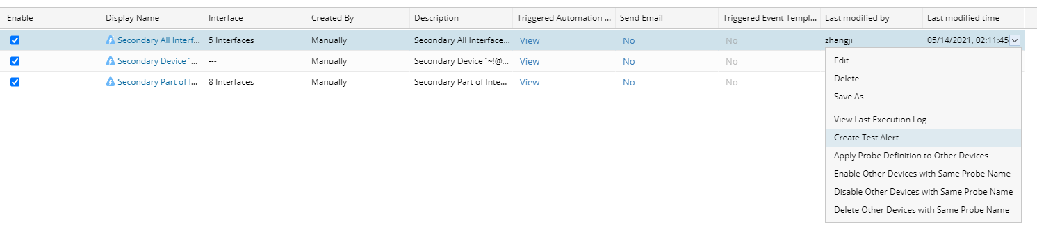

After setting up the probes and triggered intent, you may want to dry-run the system to test whether the network intent can be executed as expected. In this case, you can leverage the Create Test Alert function to conduct such tests.
Right click a probe and select Create Test Alert to generate a test alert for the current probe immediately without touching the live network. The Network Intent installed to this probe will be executed and you can view the results to see whether the Network Intent is executed as expected.
