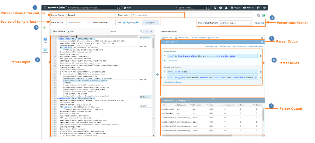

GUI and Definition Flow of Visual Parser
The graphic user interface of visual parser editor consists of 6 areas. Take the definition of paragraph parser for example:
The general flow of visual parser definition is as follows:
1.Define parser basic information in Area1.
2.Define parser qualification in Area2.
3.Select a data source and retrieve sample text from command output or device configuration in Area3. The retrieved sample text of command output of device configuration displayed in Area4.
4.Select a parser group to add and select the input box of the target line in Area5.
5.Select a line of text where the target variable resides in Area4 and click the arrow () to duplicate it to the selected line in Area6.
6.Edit line patterns to define variables in Area5 and preview the parsed result in Area7.
