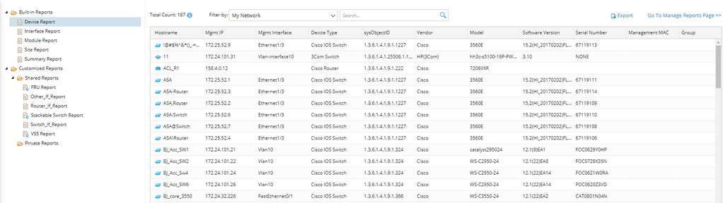

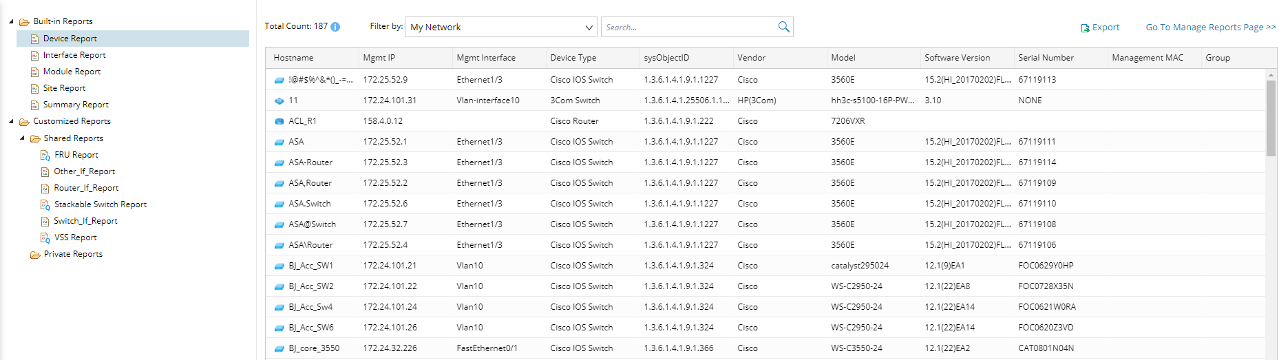

2.Select the target report in the left pane to browse asset details in the report. Its asset details are displayed in the right table.
Tip: If you select a Qapp-based report (for instance, FRU Report), you can click the
icon to specify the data source and click Run to retrieve data.

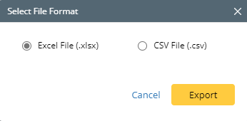

3.Click Export.
4.Select a file format (.xlsx or .csv) and then click Export.
