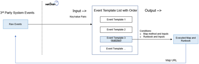

An event template is a customized executor in the NetworkBrain system to process events from a specified 3rd-party system, including mapping problem areas and executing runbooks based on predefined event conditions. With this feature, you only need to define general event templates in the NetworkBrain system, and they will process event analysis when receiving the 3rd-party events. An event template is supposed to process events from a third-party system and you can create different event templates to process events from different third-party systems.
Figure: Event Template Data Flow
