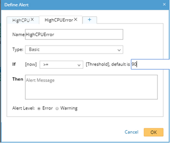

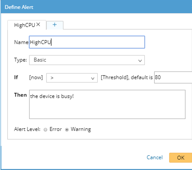

5.Click the
icon to define an alert condition for the five_sec_cpu_usage variable.
1)Enter a meaningful name for the alert, such as HighCPU.
2)Select Basic from the Type drop-down menu.
3)Select >= from the drop-down list and enter a value in the threshold field. [now] means the value of the current poll cycle, >= means larger than or equal, and [Threshold] means the limit value to trigger the alert.
4)Enter a message in the Then field. For example, the device is busy!.
5)Select an alert level. The color of a device varies from alert levels. If the Alert Level is Error, a device turns red; If Warning, a device turns yellow when the predefined threshold is reached.
Tip: You can define multiple alerts for a variable. For example, define an error alert when the CPU usage exceeds 90.
