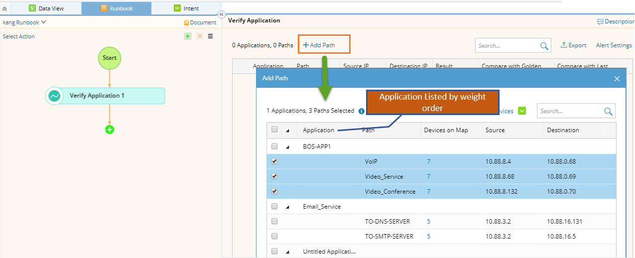

When you select paths to add them to the Verify Application node of a runbook, the applications will be listed and sorted by weight from high to low.
The weight of an application is the sum of device weight and path weight.
The device weight of an application is the sum of the weights of all devices involved in the application. When assigning devices to an application, you can manually assign a weight to each device.
The path weight of an application is the sum of the weights of all the paths contained in the application. For example, APP1 has two paths, and the weight of Path1 is 3, the weight of Path2 is 5, then the path weight of the App1 is 8.
The weight of a path depends on how many devices that the path crosses on have appeared on a map, and one device weighs 1. For example, a path crosses 5 devices, only 3 of 5 devices appear on the map, then the path weight is 3.
