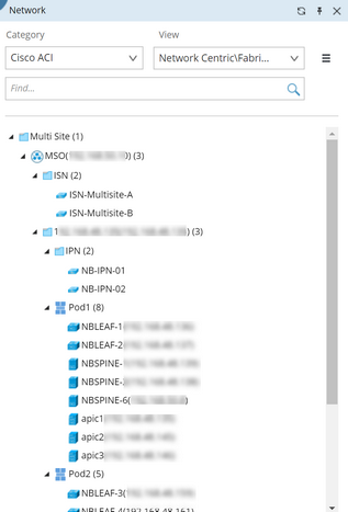

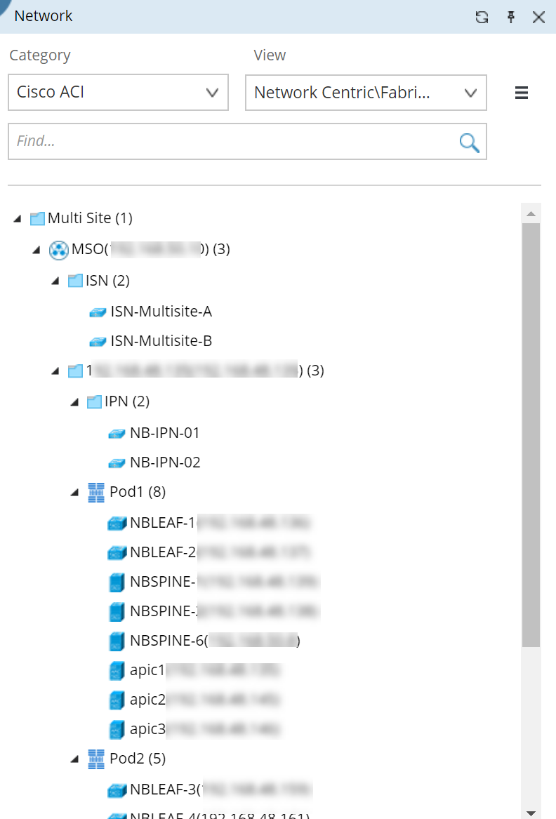

3.Expand the Multi Site node to view MSO (Multi Site Orchestrator) info.
Tip: The number next to the MSO node indicates the number of its child nodes.
4.Expand the ISN node to view all available Intersite Network Devices.
Tip: The number next to the ISN node indicates the number of its child nodes.
5.Expand the APIC Domain node to view Pod info and IPN info.
Tip: The number next to the Pod/IPN node indicates the number of its child nodes.

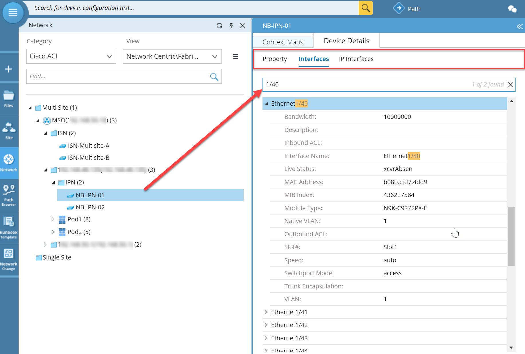

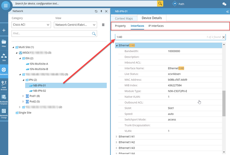

6.Click the IPN node to view all available IPN devices.
7.Click an IPN node and select the Device Details tab to view more information about the node.
Tip: You can quickly filter the desired information by using a search box on the Interface/IP Interface tab.
8.Click a Pod node to view all ACI nodes in the Pod, including Spine switches, Leaf switches, and APIC servers.

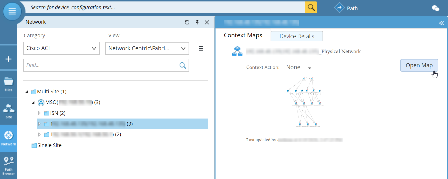

9.Select a Pod or device node, and select the Context Maps tab to view its context maps. The context map displays the physical topology of the selected Pod. You can click Open Map to view the context map.
