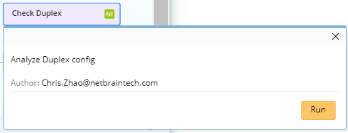

Click the desired recommended automation to view the details of the following types of recommended automation:
Automation Type
Sample UI
Network Intent
Runbook Template
CLI Command

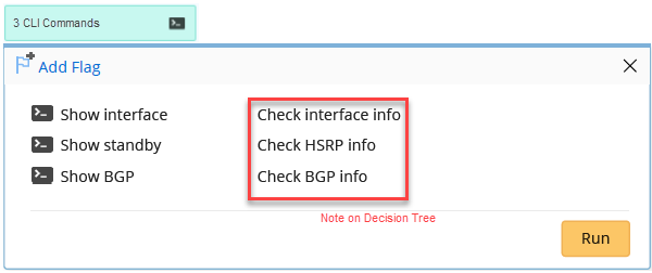

Note: If multiple CLI commands are associated with a single Flash Probe or Hypothesis, they will be grouped into a CLI Group automatically. The CLI summary view will list the grouped CLI commands.
Note: The pre-defined notes will be directly displayed in the CLI summary view instead of being displayed above the link between Flash Probe/Hypothesis and CLI command.
Executing Recommended Automation

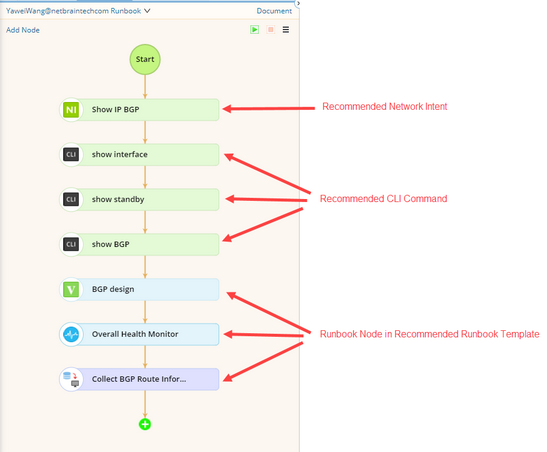

Clicking Run in the window will add the respective automation assets into the current Runbook for interactive execution, as shown below:
