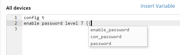

3.In a command, enter {{ and select the corresponding variable in the pop-up drop-down list.
Tip: You can use the {{variable}} to create a new variable in a command and click the variable to edit it. The new variable will be automatically added to Insert Variable.
