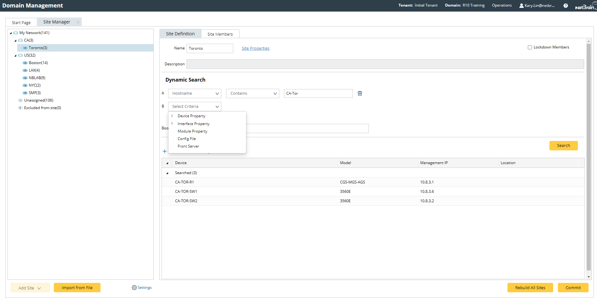

2.In the Site Manager, click My Network in the site tree and then locate Site Definition on the target leaf site.
3.Move the unassigned devices to the target leaf sites by using either of the following ways.

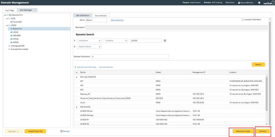

▪Dynamic Search — improve the existing Dynamic Search, such as criteria search and boolean expression. Click Search.

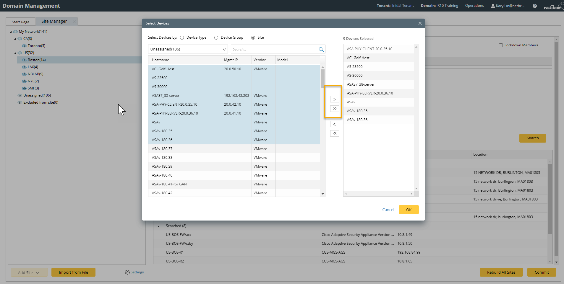

▪Manually Add — click Add Devices Manually. Under the Site option, click Unassigned and then select target devices.
4.Repeat step 1 ~ 3 to add more site members until unassigned site members are all cleaned.

5.In the Site Manager, click Rebuild All Sites to rebuild the site topology. The Site Member pane opens automatically and lists the devices in the current site.
