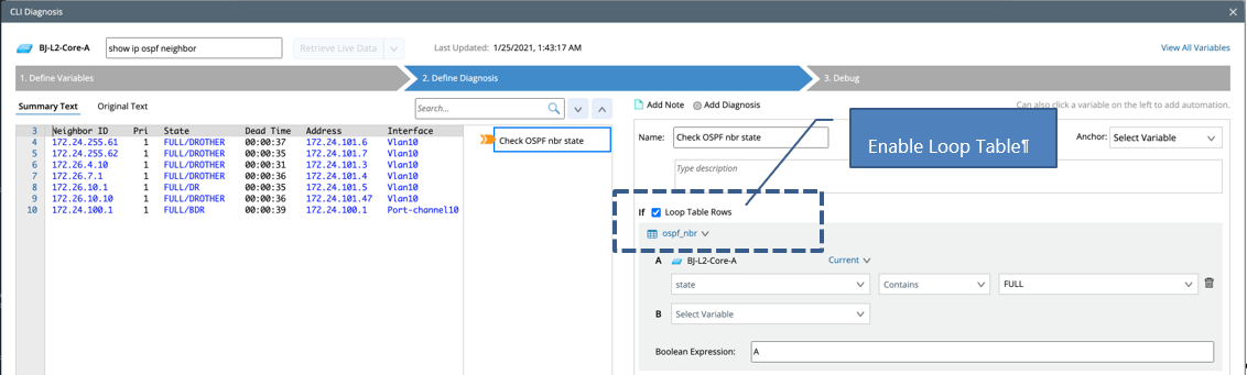

Table/Paragraph Variable
A variable can be a single variable such as $state or a table (paragraph) variable. For the table/paragraph variable, you can select the Loop Table Rows for the system to loop through each table's row. Take the OSPF neighbor table as an example. There are seven lines of neighbor information in the CLI result (the blue rows on the left). The diagnosis execution will determine whether the state contains full line by line (7 lines in total).

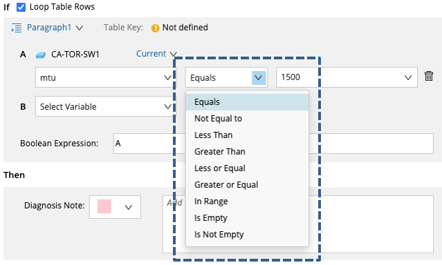

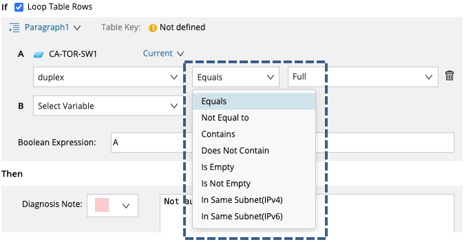

Different Variable Types
Different types of variables have various operations such as Equals, Not Equal to, Contains, etc.
Variable Type
Example
String
Int/Float

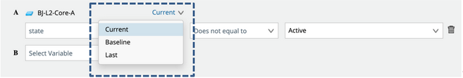

Different Data Source
For each variable defined in diagnosis, you can select its data sources:
Current: retrieved from the live data.
Baseline: the baseline data.

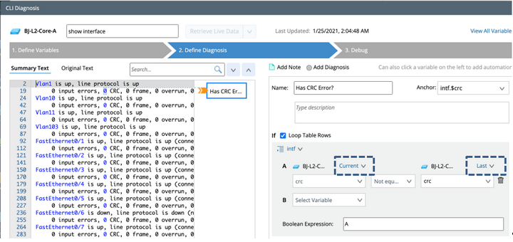

Last: the system will retrieve the data twice and compare the current data with the last data.
The following diagnosis compares the current state with the baseline state:
The following diagnosis compares the current CRC value with the last CRC value:

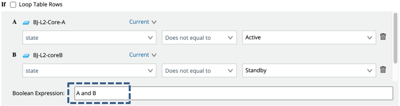

Use Compound Condition
You can have multiple simple conditions and combine them to a Boolean expression (and/or).
