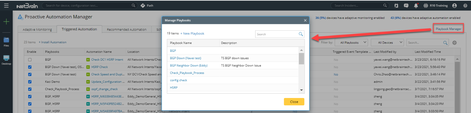

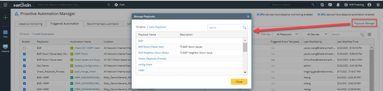

All the existing playbooks can be managed by Playbook Manager.
1.Click ,scroll down and select Proactive Automation Manager from the menu.
2.Navigate to Triggered Automation tab or Recommended Automation tab.
3.Click Playbook Manager in the right upper side.

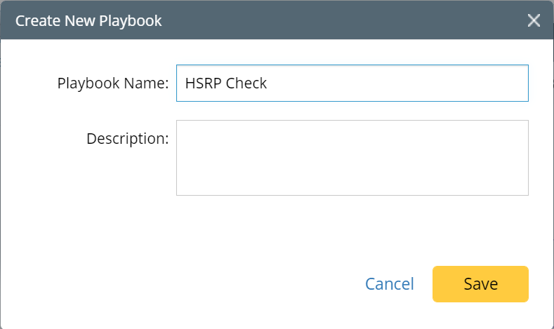

Create Playbook
Click + New Playbook and enter the playbook name (required), and description (optional) to create a new playbook.

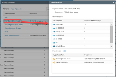

Check Playbook Details
Click the playbook name in the Mange Playbooks interface.
Add Hypothesis
To add a hypothesis, click +Add in the Playbook Details interface.

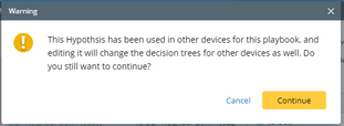

Edit Hypothesis
1.Hover over the desired hypothesis.
2.Click and select Edit from the drop-down.
3.Click Edit. A warning message will prompt.
Note: Each Hypothesis belongs to a playbook, therefore changing the Hypothesis will affect all the devices that share the same playbook containing the hypothesis.
4.Click Continue, edit the Hypothesis name and descriptions in the Hypothesis Details interface.

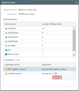

Delete Hypothesis
1.Hover over the desired hypothesis and click .
2.Select Delete from the drop-down
3.Click Delete. A warning message will prompt.
Note: Each Hypothesis belongs to a playbook, therefore deleting the Hypothesis will affect all the devices that share the same playbook containing the hypothesis.
Note: If a Hypothesis is deleted, all the relationships that include this Hypothesis also will be deleted.

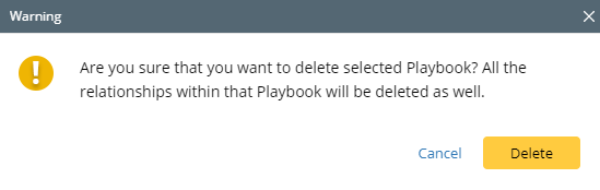

Delete Playbook
1.Hover over the playbook name in Mange Playbooks interface.
2.Click . A warning message will prompt.
3.Click Delete.
Note: When a Playbook is deleted, the included relationship also will be deleted.
