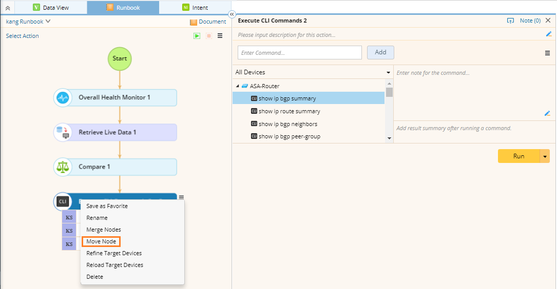

1.Select the target action node that you want to move in the runbook, and click the  icon to select Move Node.

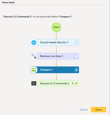

2.Select an action node to insert the target action node before it, and then click Move.

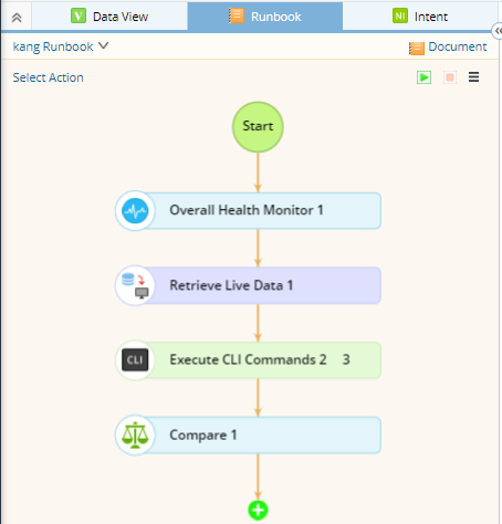

3.Browse the workflow diagram to verify the result.
