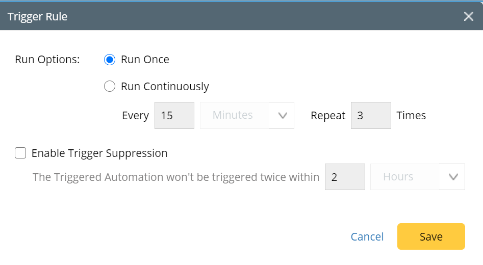

5.Define triggered rule.
oThe Network Intent can be configured to run once (default) or run continuously.
oTrigger suppression can be enabled to avoid multiple automation being triggered in a short time interval. After Trigger Suppression is enabled, the Network Intent will only be triggered once during the defined time interval. The Timer Flash Probe would not be affected by this option.
