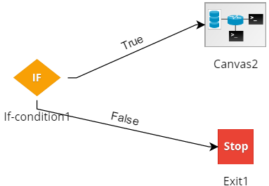

3.Select a node for True and select another one for False individually. Click Extend.
This is a sample workflow:

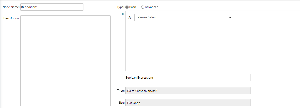

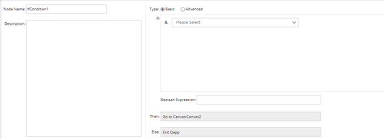

4.Click the IF node in the workflow to configure the detailed settings.
1)Enter the name and a description of the node.
2)Specify the statement type of setting the conditions:
Basicselect the variables of table attributes from the drop-down list and set conditions.
Note: Only applicable to the Canvas node which has attributes in the Global Data Table nodes.
Advancedenter the script manually. See Python scripting for reference.
