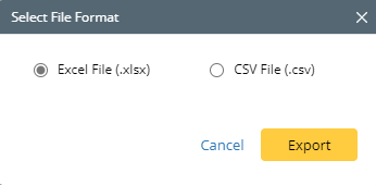

3.Click Export.
4.Select a file format (.xlsx or .csv) and then click Export.
Tip: The default location of the exported file is C:\Users\<your username>\Downloads.
