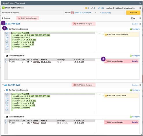

1.Open a map, and the related NIs are displayed.
2.Click an NI name to open an NI.

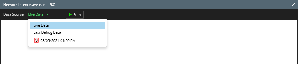

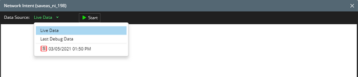

4.Click Start. The default data source is live data, you can also select other data source from the drop-down list.

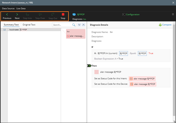

5.Use Debug control pane to view details step by step.
▪Previous: go to the previous node.
▪Next: goes to the next node.
▪Step Into: go to the node in the lower level.
▪Step Over: go to the next node in the same level.
▪Step Out: go to the next node at a higher level.
▪Stop: stop the debug mode.

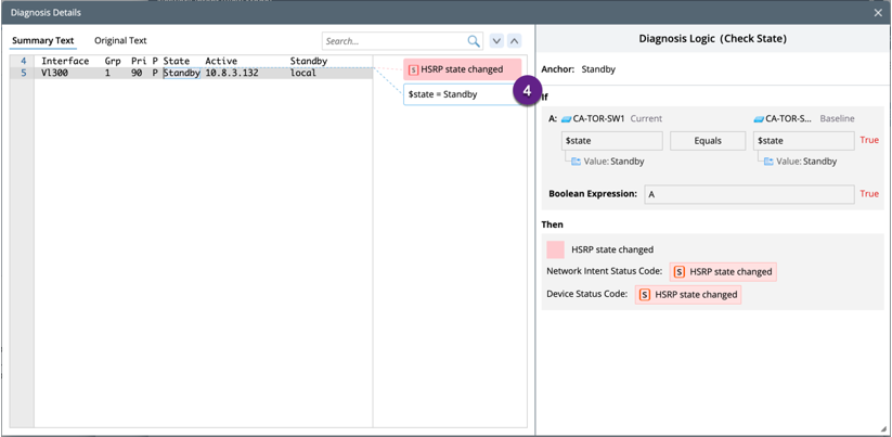

6.Click Step Into to view the details. For the table/paragraph variable, each row of data is displayed in the Diagnosis Detail pane.
