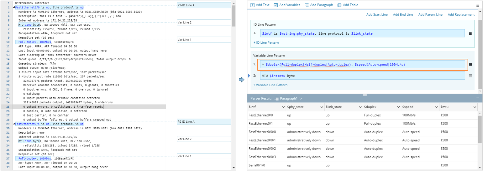

For example, to parse enumeration-type variables like $duplex and $speed, you can use $duplex(Full-duplex|Half-duplex|Auto-duplex)” and “$speed(Auto-speed|100Mb/s)” in the variable line pattern.
Note: Only the values listed in the line pattern can be successfully extracted.
