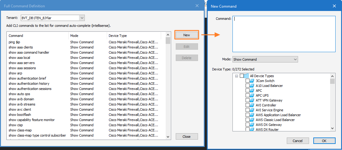

Complete the following steps to define a new full command.

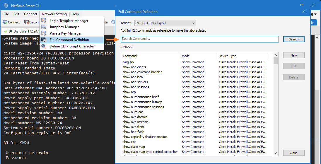

1.Click Network Setting > Full Command Definition in the Smart CLI.
2.In the Full Command Definition dialog, click New to add a new full command in the current tenant.
1)Enter a new full command in the Command field.
2)Select a mode for the command.
3)Select device types to apply the command. Click OK.
3.Click Close.
