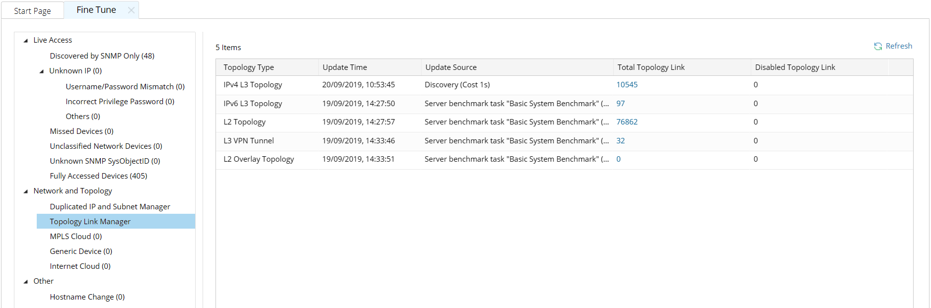

1.In the Domain Management page, click Fine Tune on the Start Page and then click Topology Link Manager on the left pane, or click Operations > Topology Manager > Topology Link Manager from the quick access toolbar.
2.In the Topology Link Manager, select the topology type that you want to edit (for example, IPv4 L3 topology) and click the hyperlink in the Total Topology Link column.

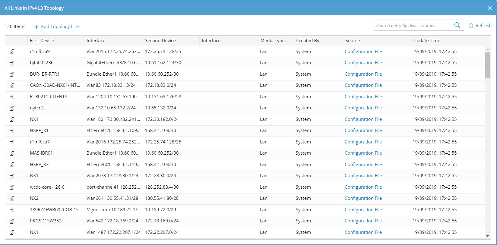

3.All links in IPv4 L3 topology are listed in the following dialog. Click Add Topology Link.
4.Select the first and the second device, and their connected interfaces for the topology link.
