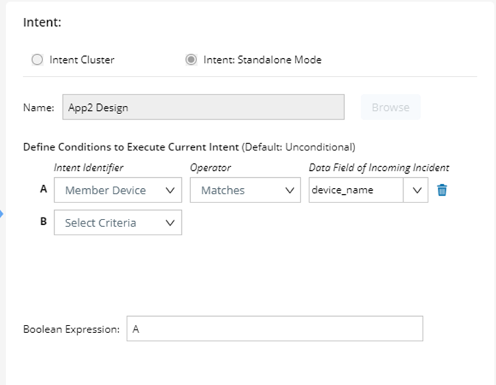

Define Conditions to Execute the NI
Define the condition if you do not intend to run the NI unconditionally.
Example: Intent App2 Design can be matched if any member device's name in the NI matches the value of the data field device_name of the incoming incident.
- Select Member Device as the intent identifier.
- Select Matches as the operator.
- Select device_name as the data field of the incoming incident.
You can combine multiple simple filters with the standard Boolean AND/OR operations.
