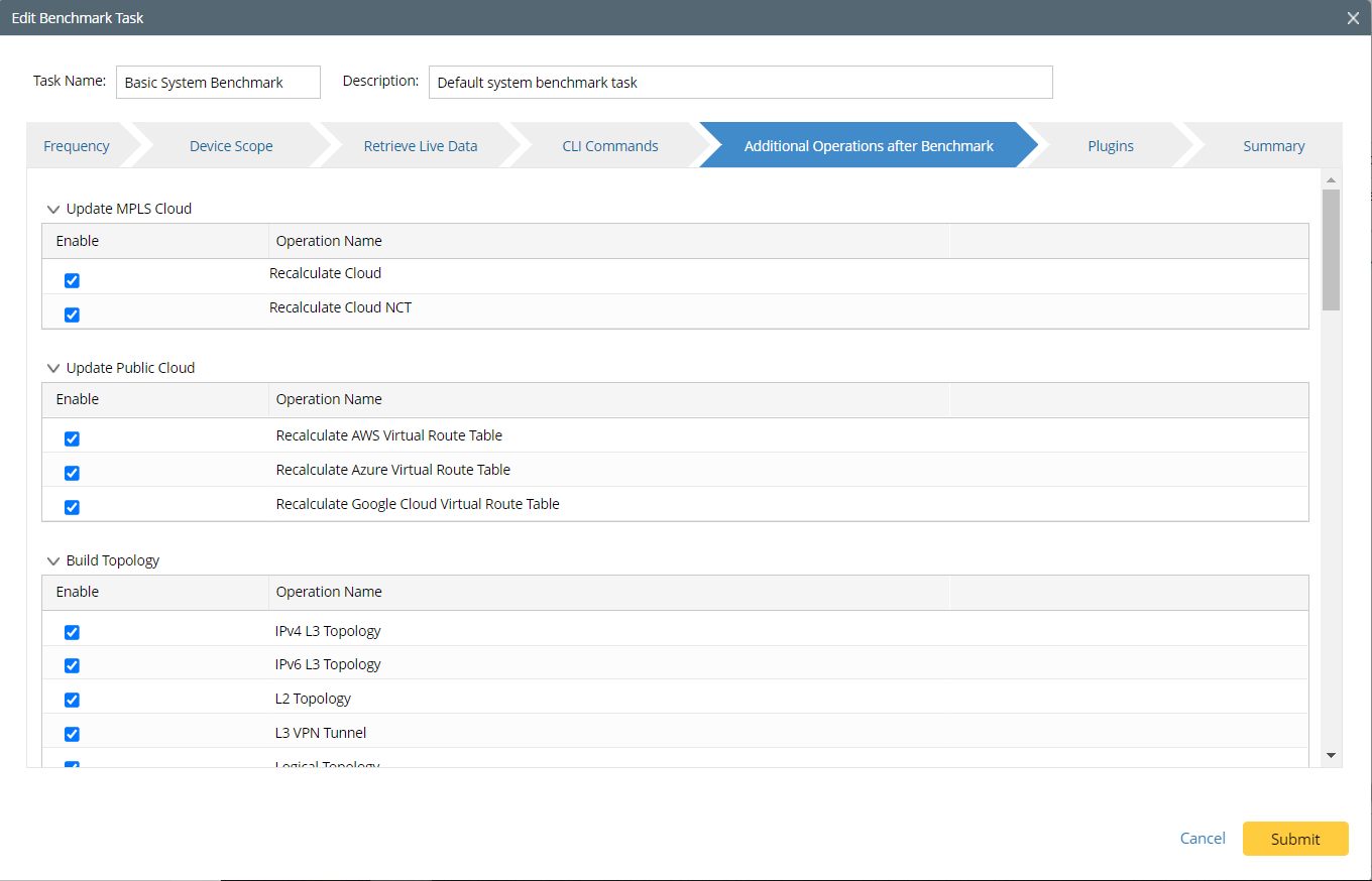

Additional Operations after Benchmark
There are many additional operations to be executed in Benchmark after the data retrieval to build topology and update system data:
  • Update MPLS Cloud
  • Update Public Cloud
  • Build Topology
  • System Operations
  • Rebuild Visual Space
  • Update Maps
  • Auto Set Golden Path
  • Application Verification
  • Run Scheduled Tasks after Benchmark
  • Email Alerts
Recommended Settings
  1. Update MPLS Cloud: Select both options Recalculate Cloud and Recalculate Cloud NCT for Basic System Benchmark if there is MPLS Cloud in your network. Sometimes large MPLS Cloud takes a long time to rebuild, and you can create an individual Benchmark task with less frequency to rebuild them. See <hyperlink to Best Practice> for details
  2. Update Public Cloud: Select all Virtual Route Tables for Public Cloud vendors you have in your network.
  3. Build Topology: Select all the options under Build Topology to keep the topology accurate. If it takes a long time to rebuild the L2 topology, you can create an individual Benchmark task with less frequency to rebuild them. See <hyperlink to Best Practice> for details.
  4. System Operations: Select all the options for the basic System Benchmark.
  5. Rebuild Visual Space: Select all the visual space templates for the SDN vendors in your domain.
  6. Update Maps: Enable Update Site Maps to keep site maps updated. You can select Yes under Export to Visio to back up the map files in Visio Format.
  7. Auto Set Golden Path:  Enable Auto Set Golden Path when there are many application paths in the domain, and it is hard to manually define the Golden Paths for them.
  8. Application Verification: Enable Application Verification by checking the Enable box. Click on +Add Application and Path to add the applications and paths for verification.
  9. Run Scheduled Tasks after Benchmark: Click on + Scheduled Data View Template/Parser Task and select built-in task to update the Built-in Data View Templates and Parsers after Benchmark.
  10. Email Alerts (Optional): Enable Email Alerts by checking the Enable box. Select the conditions to send the Email when task execution fails, or configuration file retrieval fails. Attach the execution log and live access log with failures in email.
Update MPLS Cloud
  • Recalculate Cloud — Recalculate the devices and interfaces added by the dynamic search for MPLS Cloud.
  • Recalculate Cloud NCT — Recalculate NCT tables used for path calculation with MPLS cloud.
Update Public Cloud
  • Recalculate the Virtual Route Table for AWS, Azure and Google Cloud  Recalculate the Virtual Route Tables which are used to calculate paths for AWS, Azure and Google Cloud devices.
Build Topology
Those options rebuild the L2 and L3 topology based on the latest Baseline Data to keep them updated. Make sure that the required data to build each topology type is selected in the Retrieve Live Data tab:
  • IPv4 Layer 3 Topology — requires configuration files and NDP tables (if there are IP unnumbered interfaces).
  • IPv6 Layer 3 Topology — requires configuration files and the Inventory Information of Device/Interface/Module under the Built-in Live Data category.
  • Layer 2 Topology — requires configuration files, ARP tables, NCT tables, MAC tables, NDP tables, and the inventory information of Device/Interface/Module under the Built-in Live Data category.
  • L3 VPN Tunnel — requires configuration files and GRE/IPsec VPN data in the Inventory Information of Device/Interface/Module under the Built-in Live Data category.
  • Logical Topology — builds topology for SDN network. It requires the Basic and Topology Data in the Cisco ACI, VMware vCenter, VMware NSX-V, and Cisco Meraki categories.
  • L2 Overlay Topology — builds topology for devices in an L2 overlay network.
Information Note: The processes are order sensitive. You can adjust the order by pointing to an entry and clicking the icon  to select Move Row Up or Move Row Down.
System Operations
  • Recalculate Dynamic Device Groups — recalculate the system device groups and device groups created via dynamic search.
  • Recalculate Site — recalculate the sites added via dynamic search in the Site Manager. The site topology and overview map will also be updated.
  • Build Default Device Data View — update device data in the default data view. See Default Data View for more details.
  • Qualify Data View Templates — match the data view templates with devices in the domain based on the latest retrieved data
  • Calculate Pre-Qualification — recalculate the Pre-qualification for automation assets, such as Visual Parser, Qapp, Data View and Runbook Template. Pre-qualification helps refine the target devices for automation assets.
  • Build Network Tree — rebuild the network tree based on the latest retrieved Benchmark data.
  • Rebuild the visual space for SDN devices, which includes port, topology and Data View for the ACI network. See Auto Updating ACI Data in NetBrain for more details.
    Information NoteMake sure that the IPv4 Layer3 topology option is selected in the Build Topology area.
