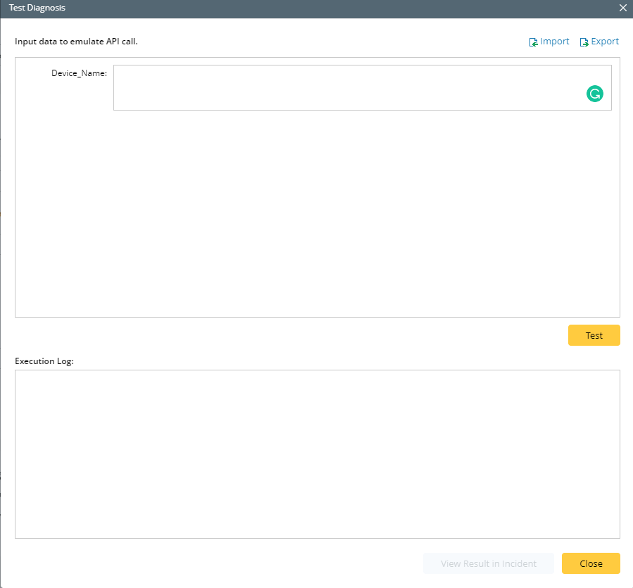

  2. Click Test in the Install Intent for Diagnosis window.
  3. In the Test Diagnosis window, Input the data fields to emulate the API call, and the system prints out the execution log with the following output:
  • The results of Incident Type.
  • Matched triggered Diagnosis.
  • Matched NI/NIT Diagnosis.
  • NI execution results if execution mode includes the execution of NI.
  • The message “Created map incident message.” if the execution mode includes the Intent Map. Likewise, the map note is displayed if the corresponding option is selected.
  • Incident devices if Set Incident Device option is set.
  • Incident message if the option is enabled.
  • Whether the incident message is successfully created by the Guidebook or Runbook template if the corresponding option is selected.
  • Whether the subscription to preventive automation is successfully enabled if it is configured.
 A View Result in Incident button is provided to view the Incident for this incoming call.
  1. Click Close to close the Test Static Diagnosis window.
