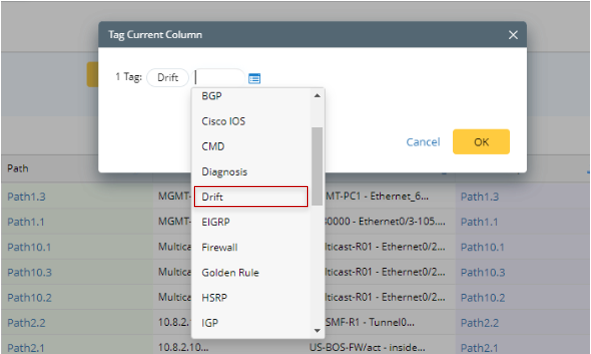

A network asset in ADT may be associated with multiple Intents and maps, for example, ADT asset can associate with Performance Monitor, Security Check, or QoS Check intents for an application path. Automation tags are used to classify the intents/maps in ADT columns so that the different intents/maps can be used respectively in different network scenarios of events.
  • Tag automation column: Open the Tag Current Column dialog from the drop-down menu of the target automation column, then enter the tags.
    1. Open the target ADT in ADT Manager.
    2. From the drop-down column of the automation column, select Tag Current Column.
    3. In the pop-up dialog, click + Add to select tags (for example, tag "Drift") from the drop-down list.
    4. Click OK to add the tags.
