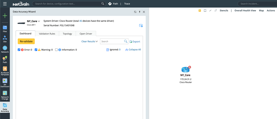

  1. You can check if the Open Driver successfully fixes the data accuracy issues.
Example:

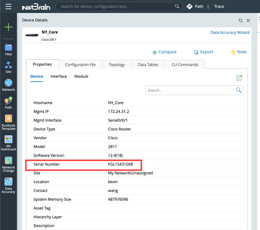

To see if the serial number is filled in after the Open Driver is executed:
  1. Navigate to the device's Device Details Pane.
  2.  On the Properties tab, click Device, and view the Serial Number.
  3. Open Data Accuracy Wizard, click Re-validate.
  4. No errors are generated. The serial number issue is fixed.
