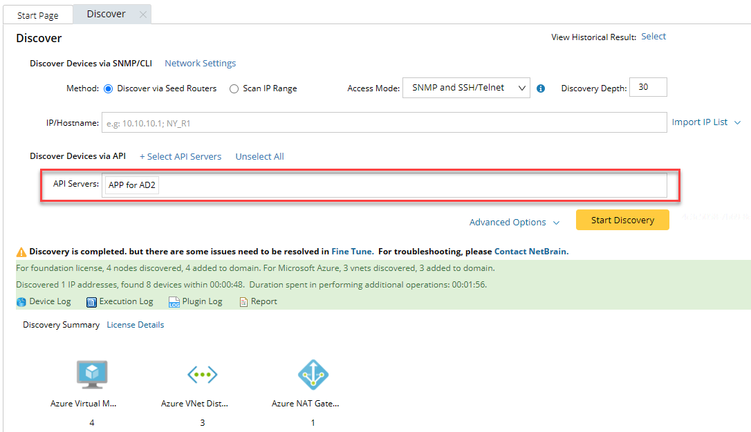

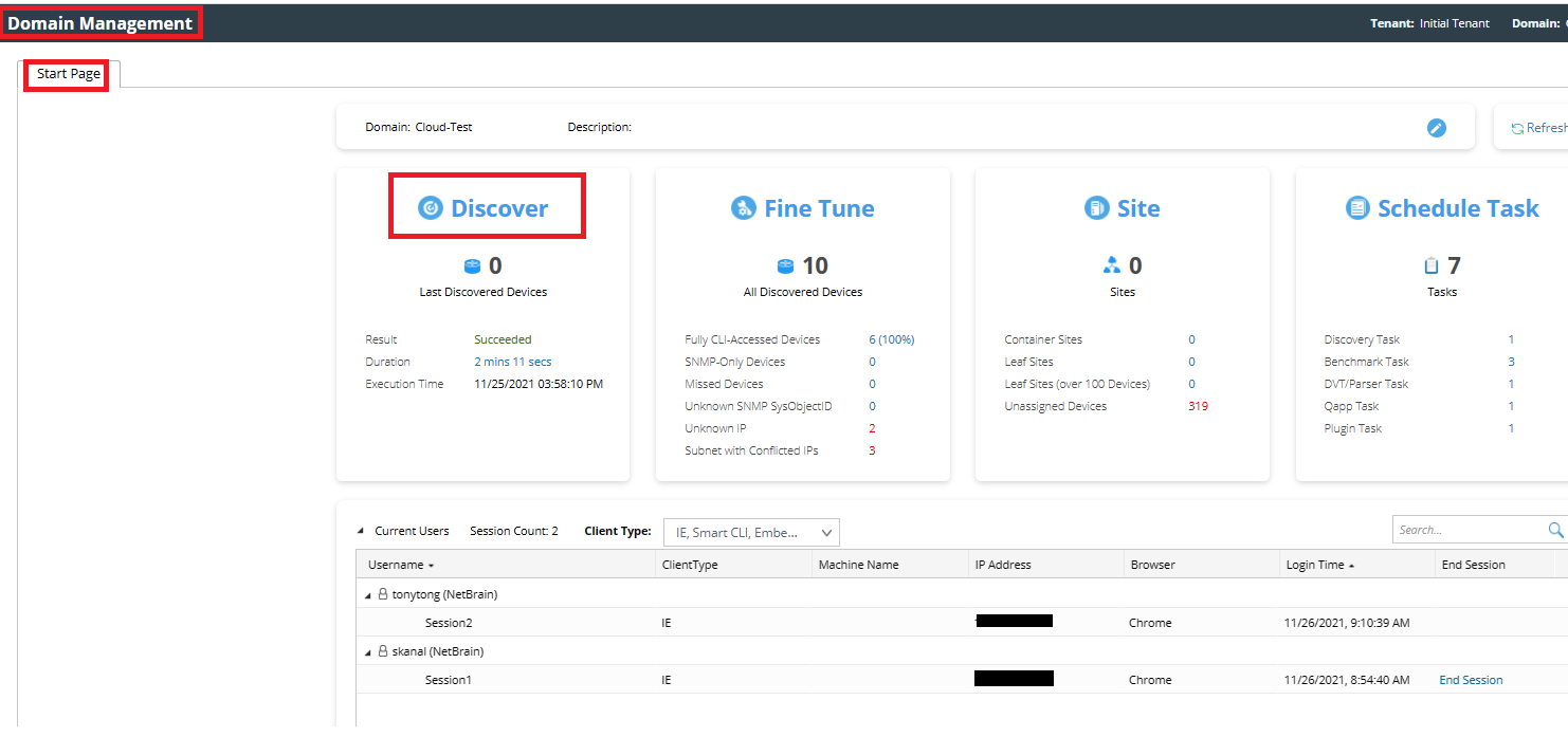

  1. Log in to your NetBrain IE system.
  2. Click the Discover link from the Domain Management page.

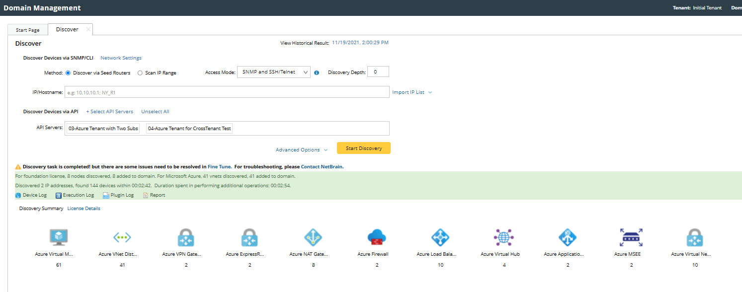

  3. Click + Select API Servers and select the Azure API Server you just created.
  4. Click Start Discovery to start the Azure discovery. Run the discovery task manually or schedule a discovery task to discover Azure resources.
  5. Wait till the discovery finishes. The number of discovered objects will be displayed.
