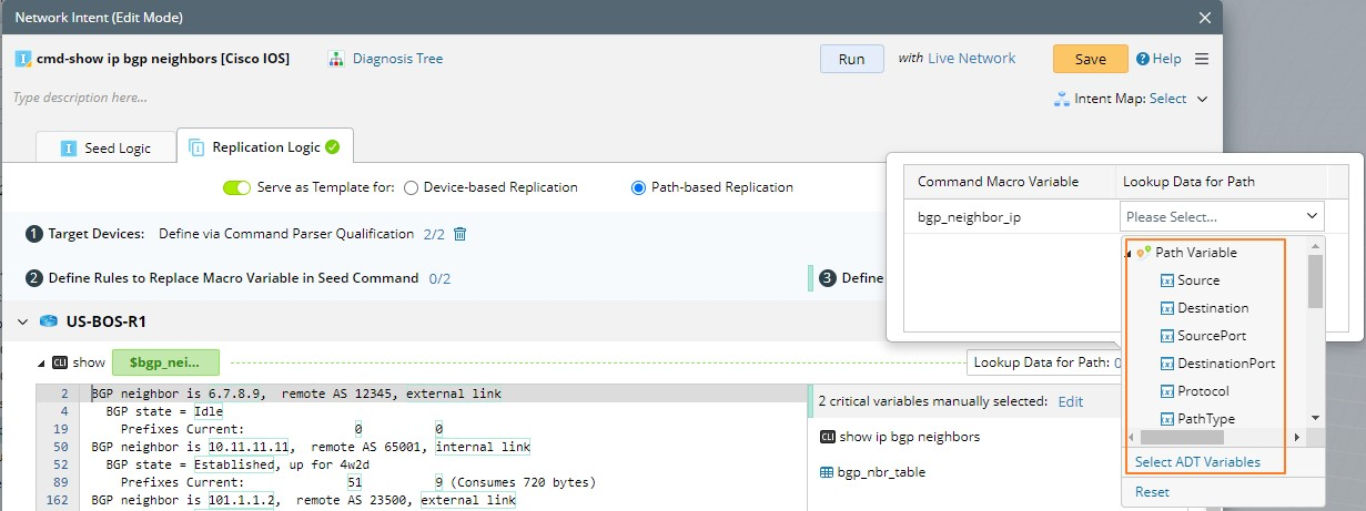

  • Lookup Data for Device in device-based replication mode: Define the value bound to the macro variable for decoding devices. You can set whether to use the default value or ADT value for intent decoding.
  • Lookup Data for Path in path-based replication mode: The path variables and ADT variables are supported here.

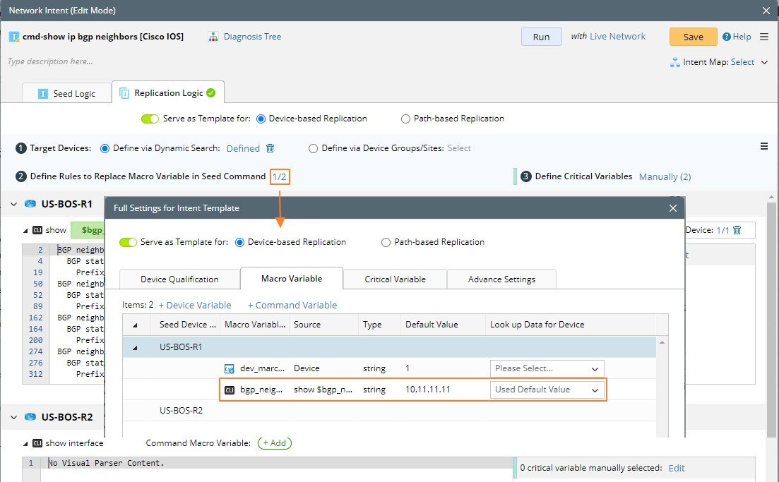

  1. After the macro variable for seed command is defined, this variable is displayed under the Macro Variable tab in Full Settings for Intent Template.
To define the device macro variables, see Manage Macro Variable for more information.
