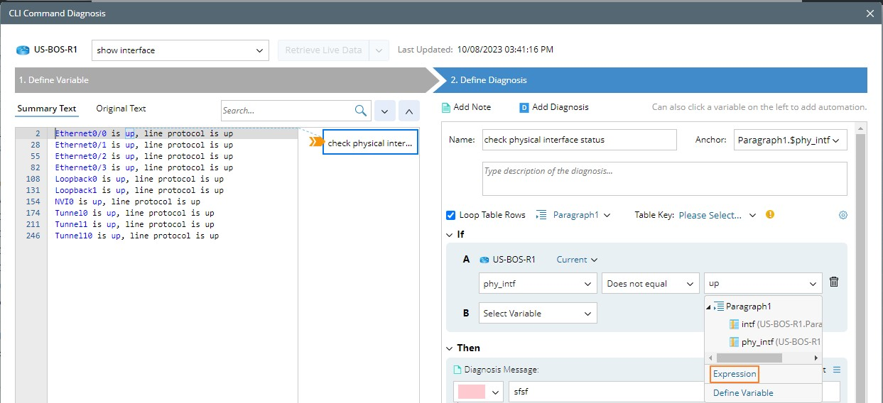

You can use the inline expression in the definition of a simple diagnosis instead of defining a compound variable and then using that variable in the diagnosis.

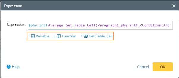

  1. Click Expression.
  2. Define the variable and expression.
    1. Click + Variable to select the variable that needs to be referenced in the expression.

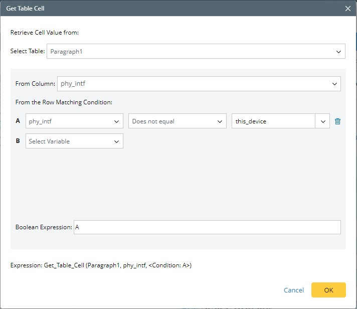

    3. Click + Get_Table_Cell to define where the cell value comes from.

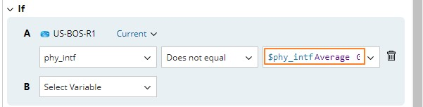

  3. View the defined expression in the diagnosis.
