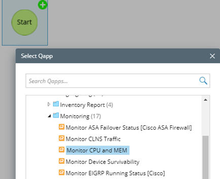

  3. Point to the Start node and click the icon to add the Monitor CPU and MEM Qapp.

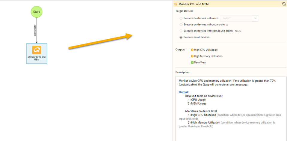

    Information Tip: Click a Qapp node to view the target devices, outputs, and description of the Qapp.

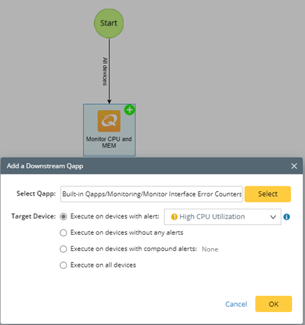

  1. Point to the Qapp node, click the icon to add a downstream Qapp node to check interface parameters of the devices with high CPU:
    1. In the Add a Downstream Qapp dialog, click Select to select the Monitor Interface Error Counters Qapp.
    2. Specify target devices for the downstream Qapp. In this case, select Execute on devices with alert and then select the High CPU Utilization alert. It means that the downstream Qapp will execute on the devices that trigger the High CPU Utilization condition defined in the current Qapp node. See Target Devices for more details.
    3. Click OK.
