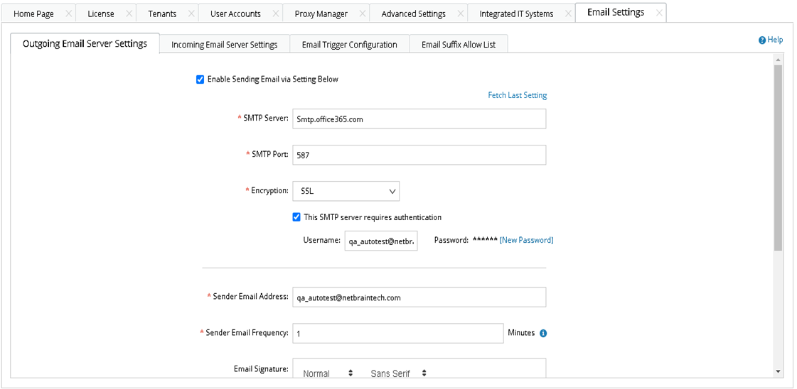

To configure Outgoing Email Server Settings, complete the following steps:
  2. On the System Management page, select the Email Settings tab.
  3. In the Email Settings > Outgoing Email Server Settings tab, select the Enable Sending Email Server Settings check box.
  1. Configure the following fields.
    FieldDescriptionDefault Value
    SMTP ServerSpecify the IP address of an SMTP server.-
    SMTP PortSpecify the port number that the SMTP server listens to. 25
    EncryptionSpecify the type of encrypted connection, such as SSL or TLS. You also require authentication for logging in the SMTP server by selecting the corresponding check box. -
    Sender Email AddressSpecify the email address for system emails.-
    Password (Optional)Select to specify a password of the sender's email address.-
    Send Email FrequencySpecify the time interval for email alerts. The system will not duplicate email alerts to receivers until the specified time interval has passed.5 minutes
    Email Signature (Optional)Set up an email signature that can be applied to all system emails.-

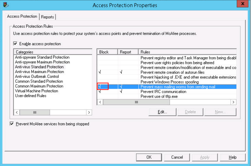

Information Tip: Before saving the changes, you can click Test to verify whether the settings are valid.
  1. Click Save.
Information Note: If the antivirus software McAfee has been installed on the NetBrain Application Server (Web Server), you need to check whether the mass mailing service is blocked by the McAfee process as follows, which may cause the failure of mail delivery.
