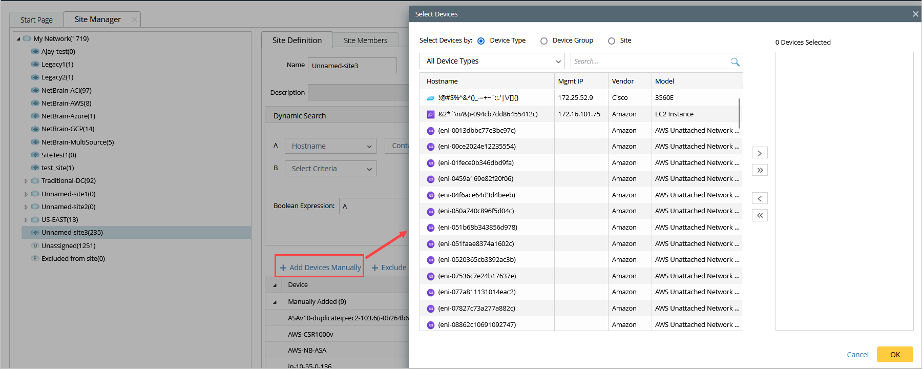

  4. Add devices to the leaf site using the following ways:

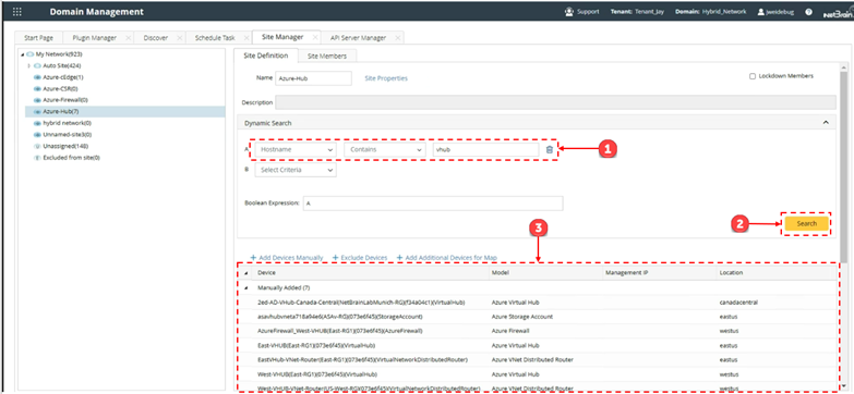

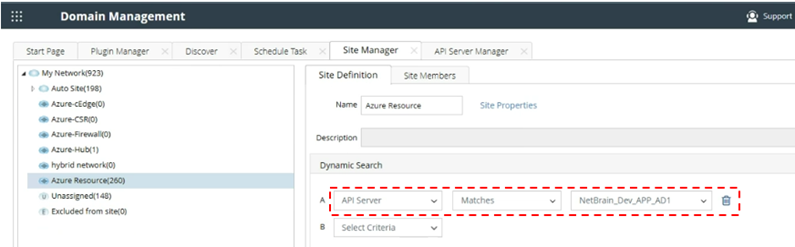

    • Dynamic Search — specify search criteria and a Boolean expression and then click Search. See Dynamic Search for more details. You can now include SDN and Public Cloud devices in the Site.
      Your can use the new API Server search criteria to make it easy to add SDN and Public Cloud devices to your Site.
  • Manually Add — click Add Devices Manually and then pick out devices from a device group, a site, or a device type.

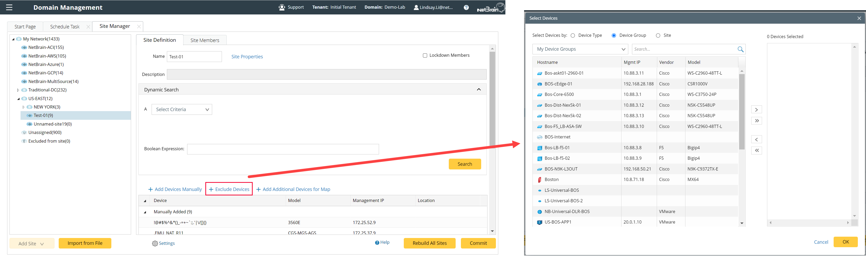

  • Exclude Devices — Click Exclude Devices and select the devices from any Device Type/Device Group/Site that you wish would not include in this leaf site. When you define the devices by the Dynamic Search, the excluded devices defined here will be assigned to this leaf site even if they satisfy the dynamic search.

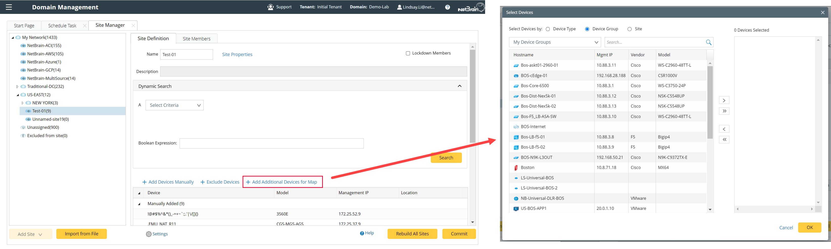

  • Add Additional Devices for Map — This is a special feature that allows you to add devices to a Site map while do not include them as Site members. A device can only belong to one Site, but it can belong to multiple Site maps.

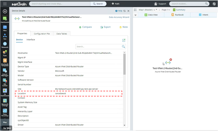

5. To define a site, enter the Region or Location in the Public Cloud Node. These two attributes are commonly used by users to define the site.
     To check the device location:
  1. In the Search bar, enter your device name.
  2. In the search results, point to the device and click the  icon to select View Device Details.
  3. In the Device Detail pane, check for the Location.
