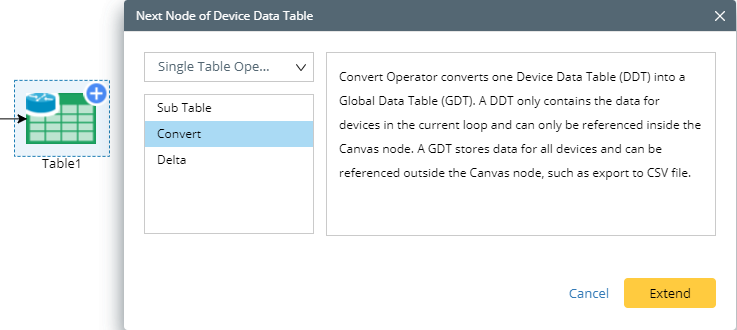

To convert a Device Data Table to a Global Data Table:
- Point to the Table1 node, click the
icon. - Select Single Table Operator > Convert from the drop-down menu and click Extend. Another table node (Table2 in this sample) is created after the Convert node, and no settings are required.
