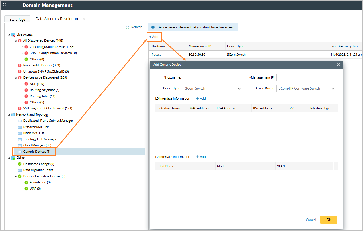

  2. On the Domain Management page, click Data Accuracy Resolution on the Start Page.
  3. On the Data Accuracy Resolution tab, click Generic Device in the left pane.
  4. Click Add and define the generic device information.

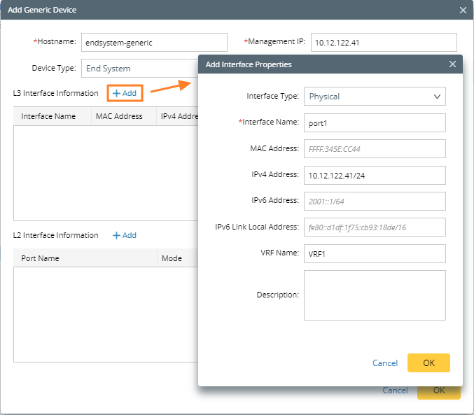

1) In the Add Generic Device pane, enter the hostname and management IP, and select the device type from the drop-down list. The device driver is automatically selected based on the device type.
2) Click Add in the L3 Interface Information area to define the L3 interface properties according to the actual situation, such as interface name and VRF name. Then click OK.

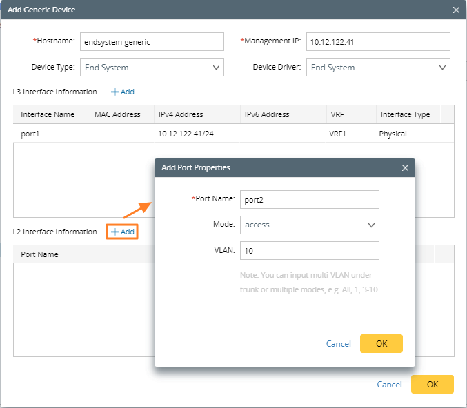

3) Click Add in the L2 Interface Information area to define the L2 interface properties according to the actual situation. Then click OK.
  1. Click OK.

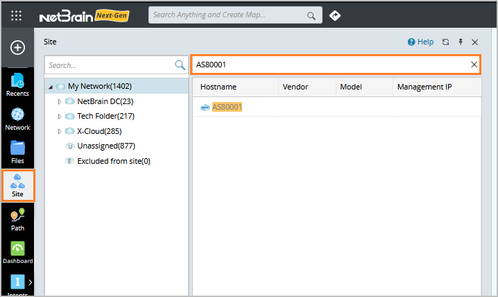

  1. To find the added device, click Site on the taskbar and search for the device name, and then press Enter to see the device.
