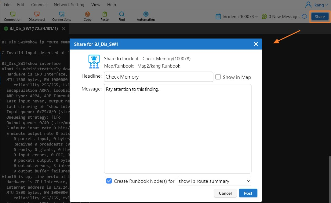

Complete the following steps to share findings.
  1. Click Share.
  2. In the pop-up dialog, define the information that will be published to the incident.
    1. Enter a brief description as a headline. You can select the Show in Map check box to make the headline displayed.
    2. Enter a message.
    3. Select the Create Runbook Node(s) for checkbox, and choose the content to be published from the drop-down list.

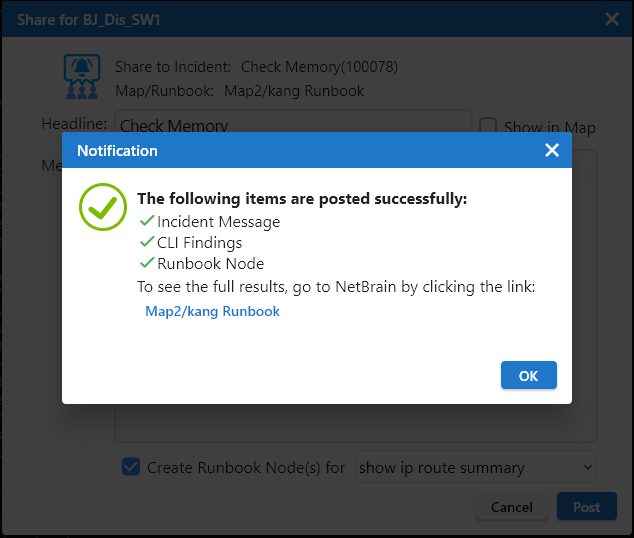

  1. Click Post. In the Notification dialog, click the created map/runbook link to switch to the NetBrain System for your further operations.
