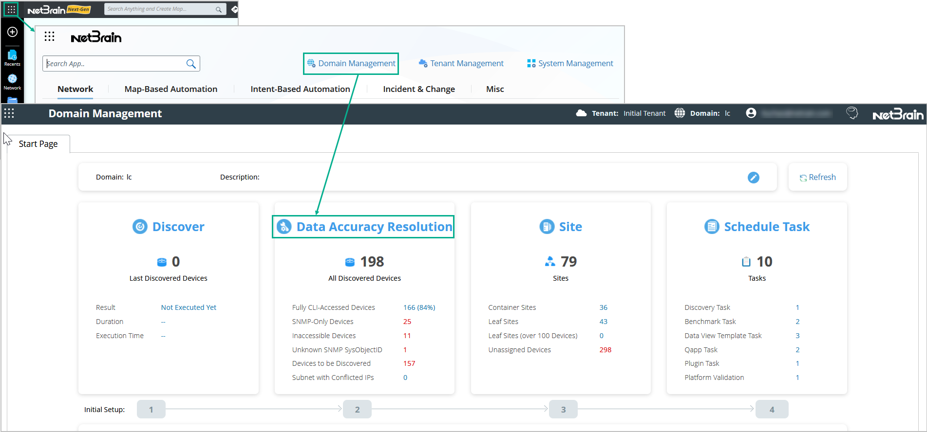

  2. In the Domain Management page, click Data Accuracy Resolution on the Start Page or select Data Accuracy Resolution from the start menu.

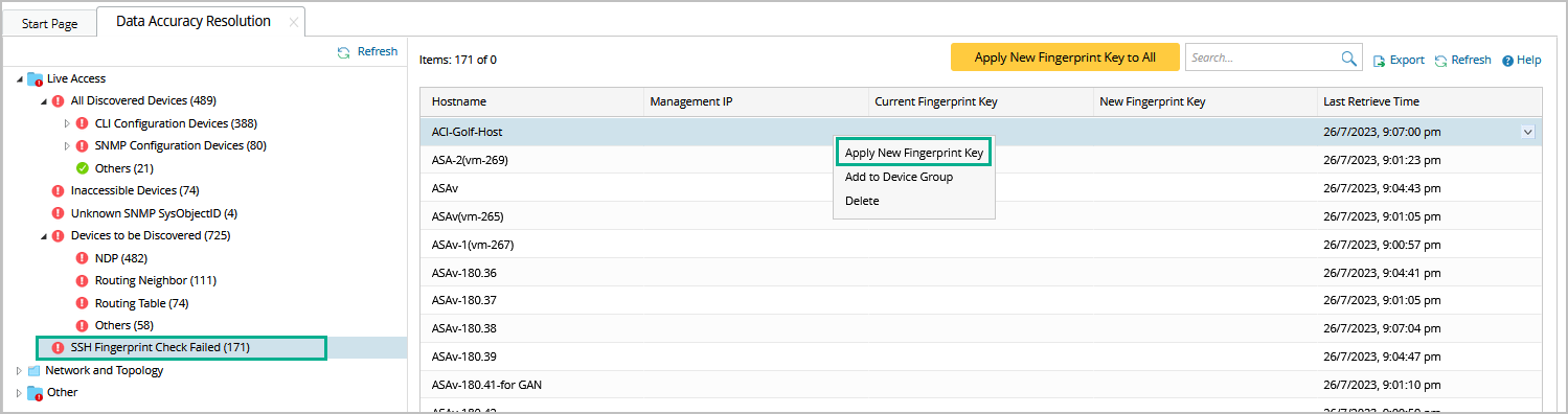

  3. On the Data Accuracy Resolution  tab, select SSH Fingerprint Check Failed in the left pane and all devices with SSH fingerprint check failed are listed.
  4. Right-click the target device and select Apply New Fingerprint Key, then click Yes in the prompt box. The resolved item will be removed from the table.
Information Note: You can also click Apply New Fingerprint Key to All for all the devices in the current domain.
