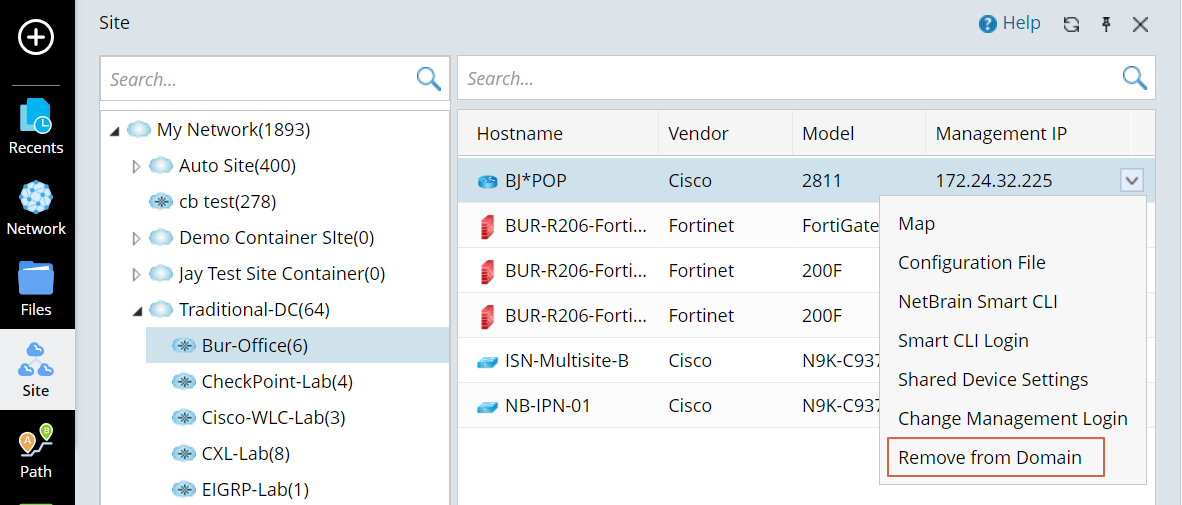

- Remove the device from Site pane
- Click Site on the taskbar.
- Right-click the target device and select Remove from Domain from the drop-down list.

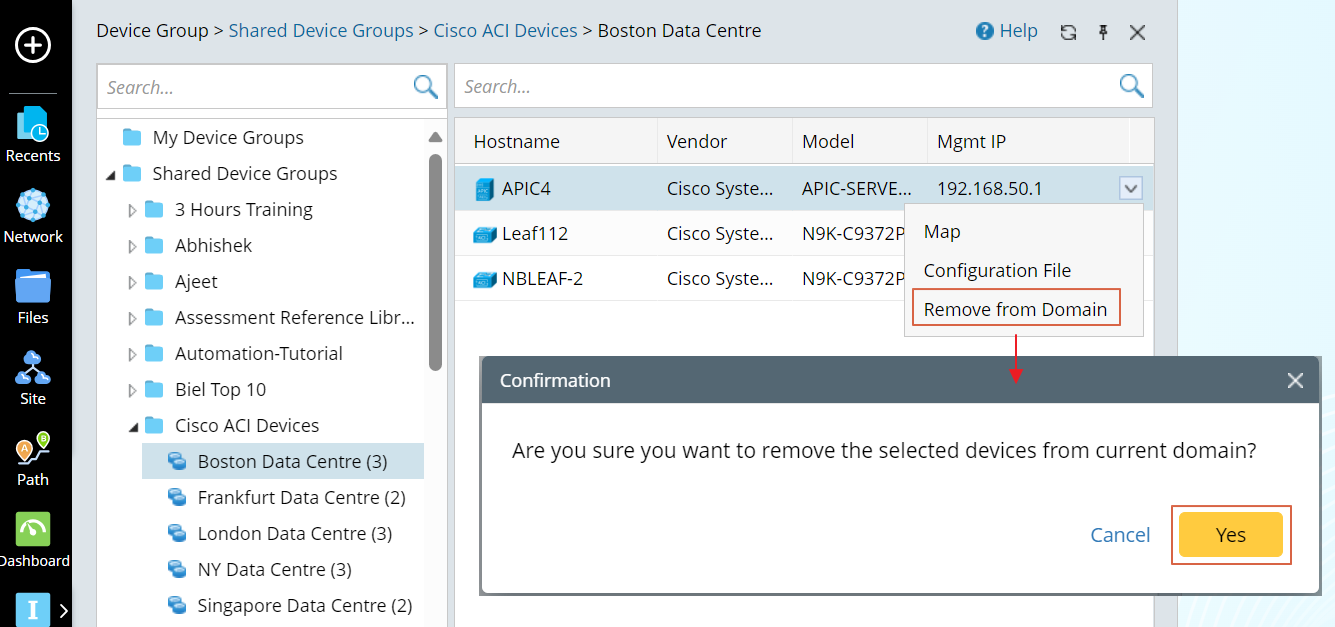

- Remove the device from Device Group
- Click the target device group and all the devices in this group are displayed in the left pane.
- Right-click the target device and select Remove From Domain from the drop-down list.
- In the pop-up dialog. Click Yes.
Note: You can also right-click the target device group and select Delete to delete the device group.
Tip: The devices in the System folder cannot be removed in this way.

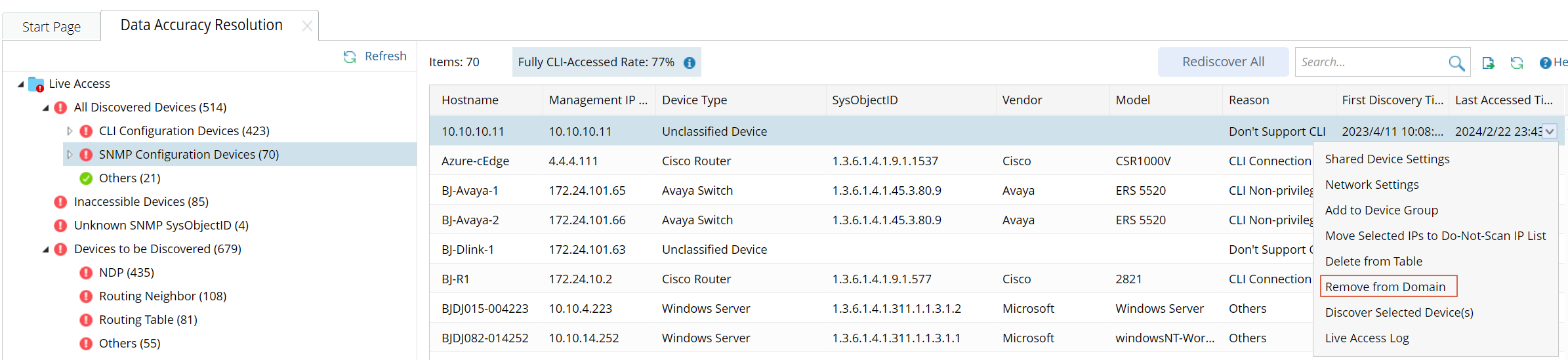

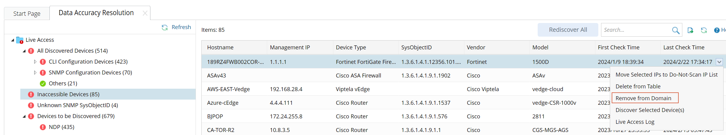

- Remove device from Data Accuracy Resolution
- Log into Domain Management page.
- In the Domain Management page, click Data Model > Data Accuracy Resolution from the quick access toolbar.
- On the Data Accuracy Resolution tab, there are two ways to remove a device:
- Click Inaccessible Devices, and right-click the target device in the table and select Remove from Domain.
- Click SNMP Configuration Devices, and right-click the target device in the table and select Remove from Domain.

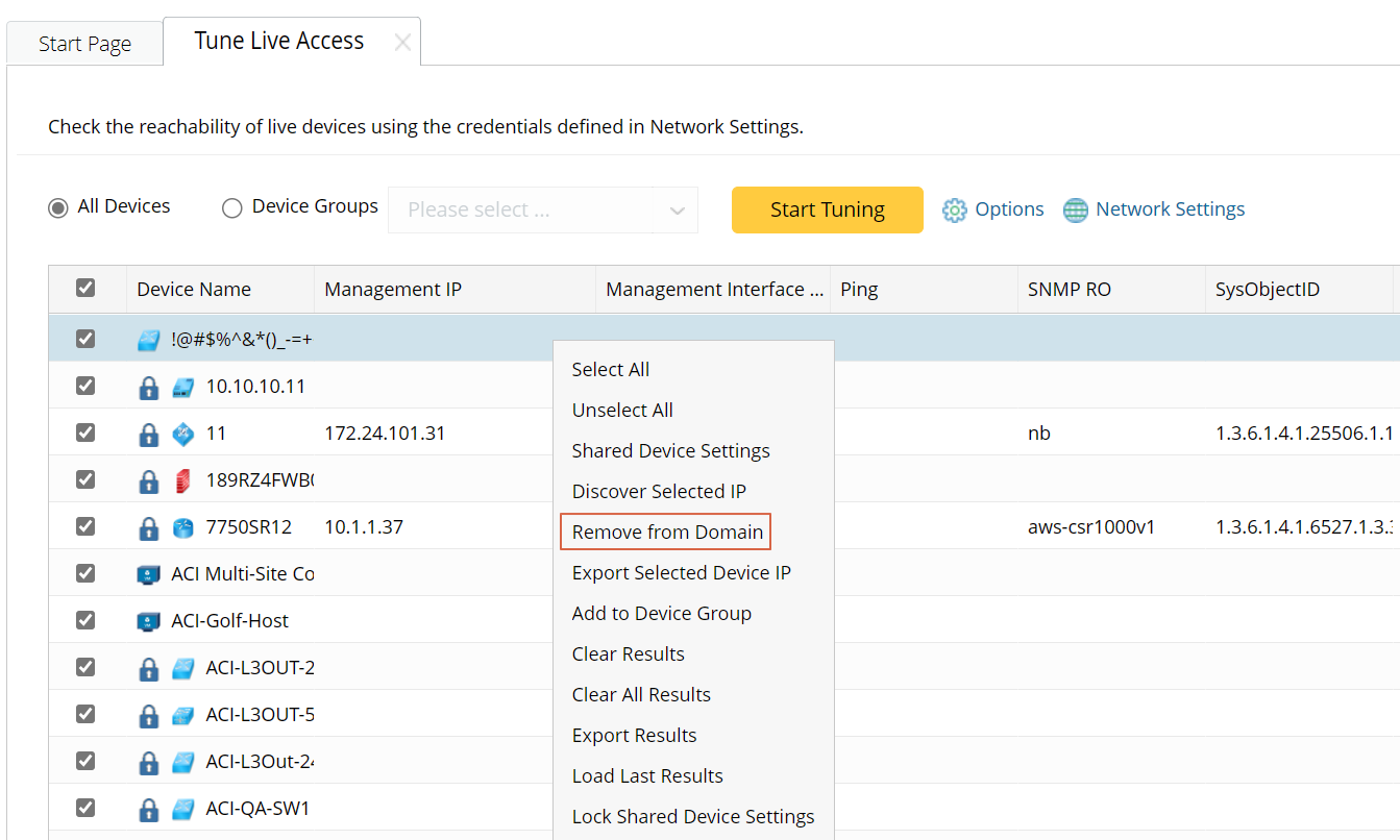

- Delete devices from Fine Tune result
- In the Domain Management page, click Benchmark > Tune Live Access from the quick access toolbar.
- On the Tune Live Access tab, open the fine tune result table, check the box and right-click the target device to select Remove from Domain.
