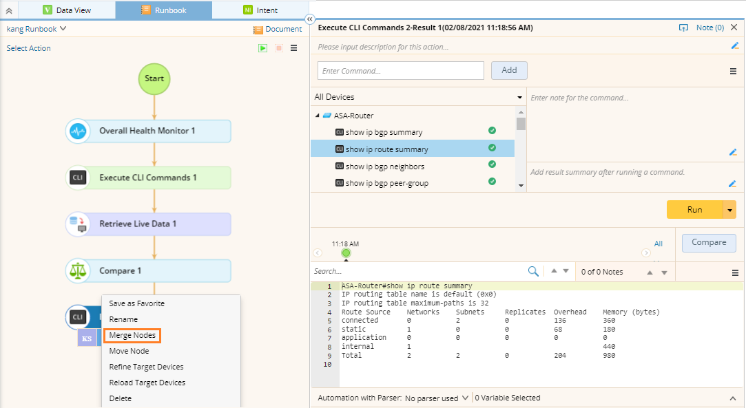

- Select the target action node you want to use as the final node to merge other action nodes of the same type in the Runbook, and then click the
icon to select Merge Nodes.
- Select the corresponding check box to include the desired actions of the same type. Click Merge.
- Click the target action node to browse all the execution results.
