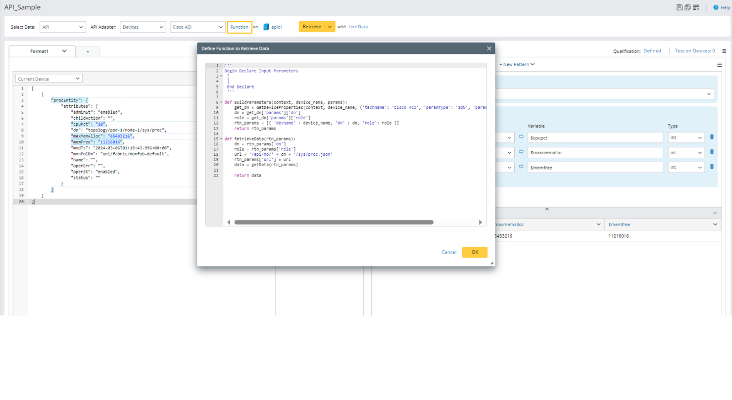

    2. Click Function to define the python script. This will decide how to get data from the API server.
      The sample Python script is shown below:
      Python
      Begin Declare Input Parameters
      End Declare
      def BuildParameters(context, device_name, params):
      get_dn = GetDeviceProperties(context, device_name, {'techName': 'Cisco ACI', 'paramType': 'SDN', 'params' : ['dn','role'] })
      dn = get_dn['params']['dn']
      role = get_dn['params']['role']
      rtn_params = [{ 'devName' : device_name, 'dn' : dn, 'role': role }]
      return rtn_params
      def RetrieveData(rtn_params):
      dn = rtn_params['dn']
      role = rtn_params['role']
      url = '/api/mo/' + dn + '/sys/proc.json'
      rtn_params['url'] = url
      data = getData(rtn_params)
      return json.dumps(data,indent=4)
  3. Click the Retrieve button to retrieve JSON-formatted text.

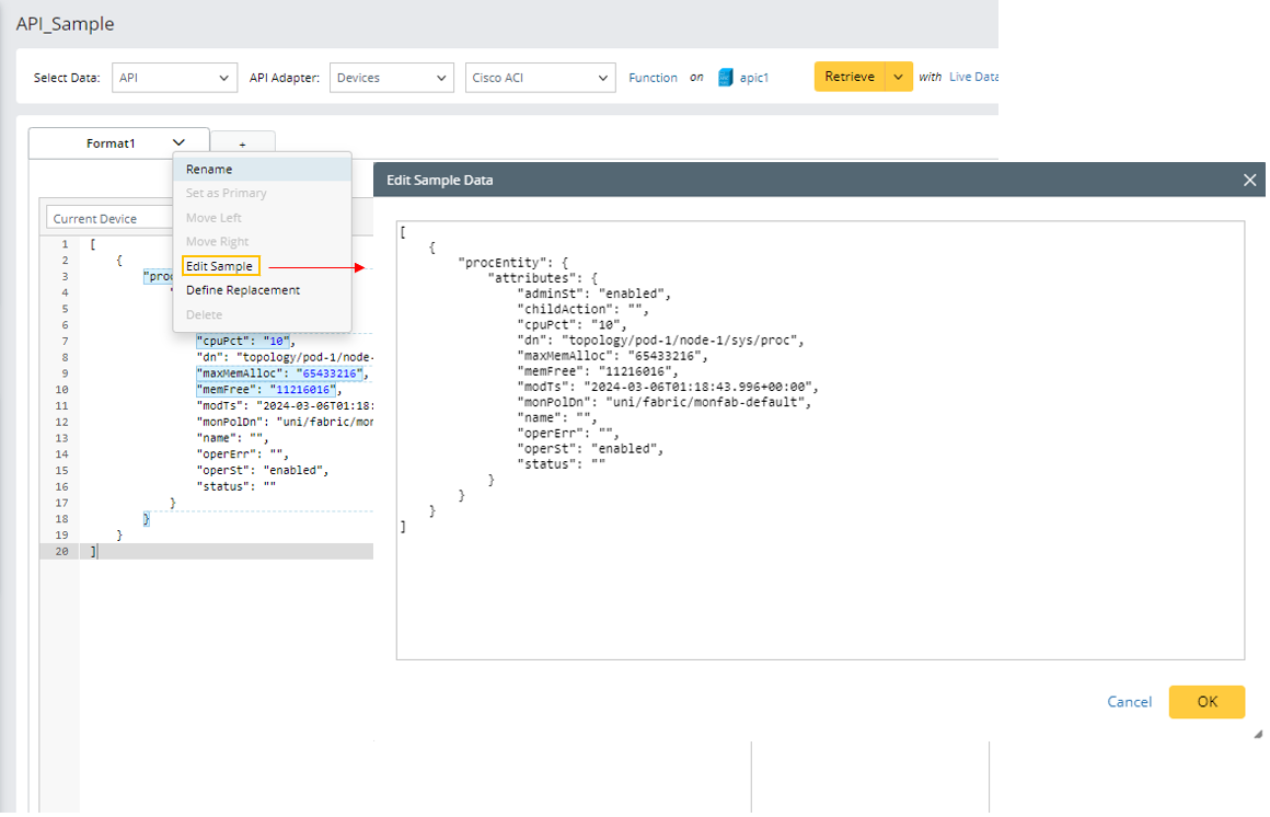

    Alternatively, you can manually input JSON-formatted text in the left Sample Data pane. Click Edit Sample from the format menu, then manually input/edit the parser input.

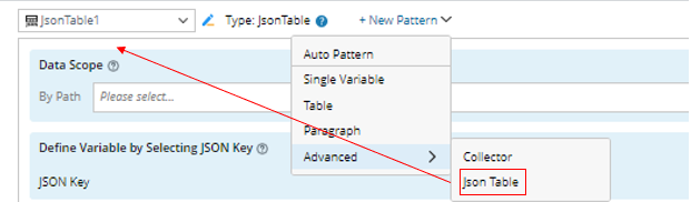

  4. After the input text is ready, you can continue to define the JSON table type in the right pane. Select Json Table from the New Pattern menu to create a JSON Table type.

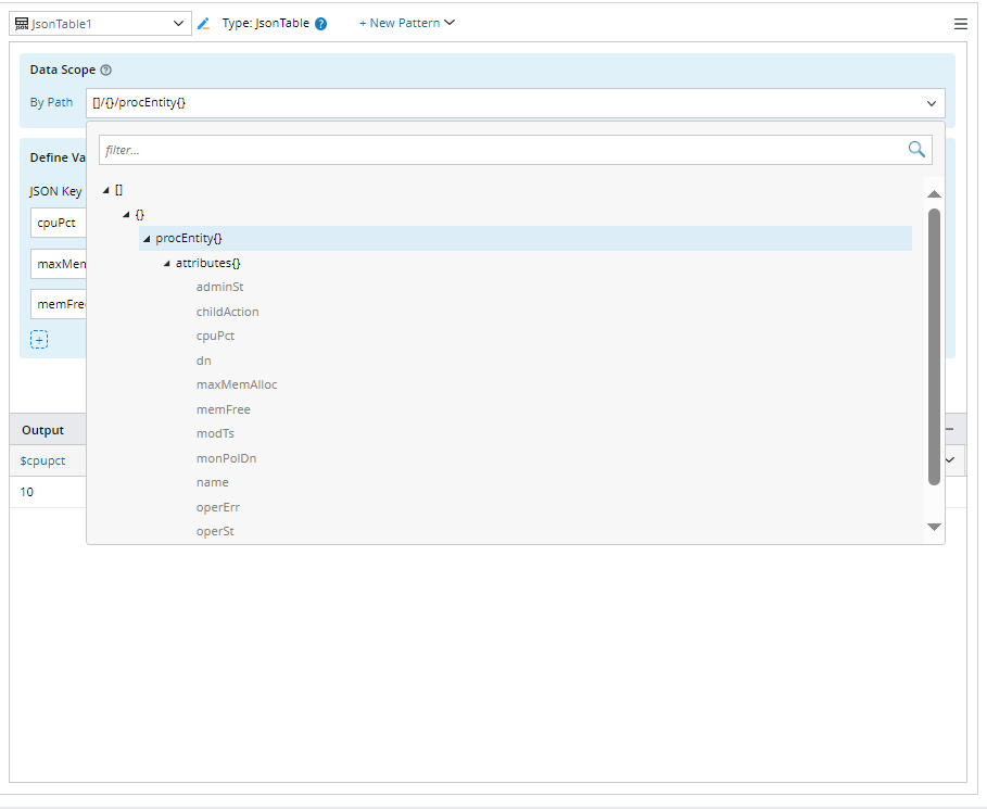

  5. In the By Path block, select a path from the By Path tree structure to determine which table section in the JSON-formatted text will be parsed. The JSON keys selected in the next step come from the table section determined in the JSON-formatted text.

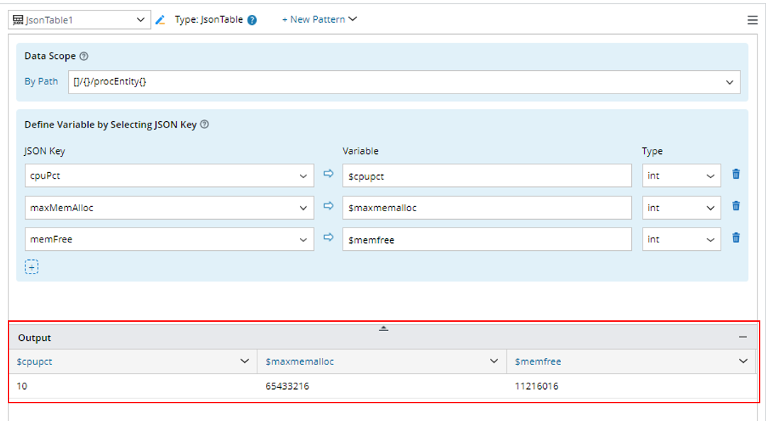

  6. In the Define Variable by Selecting JSON Key block, click  to display the JSON Key tree, then select JSON key as parser variable, then you can change the variable type.
    Information Tip: You can click to add more variables using JSON Key.
  7. View the parsed results: For a JSON Table type parser, the parsed results are in table format, which are displayed in the Output area.
