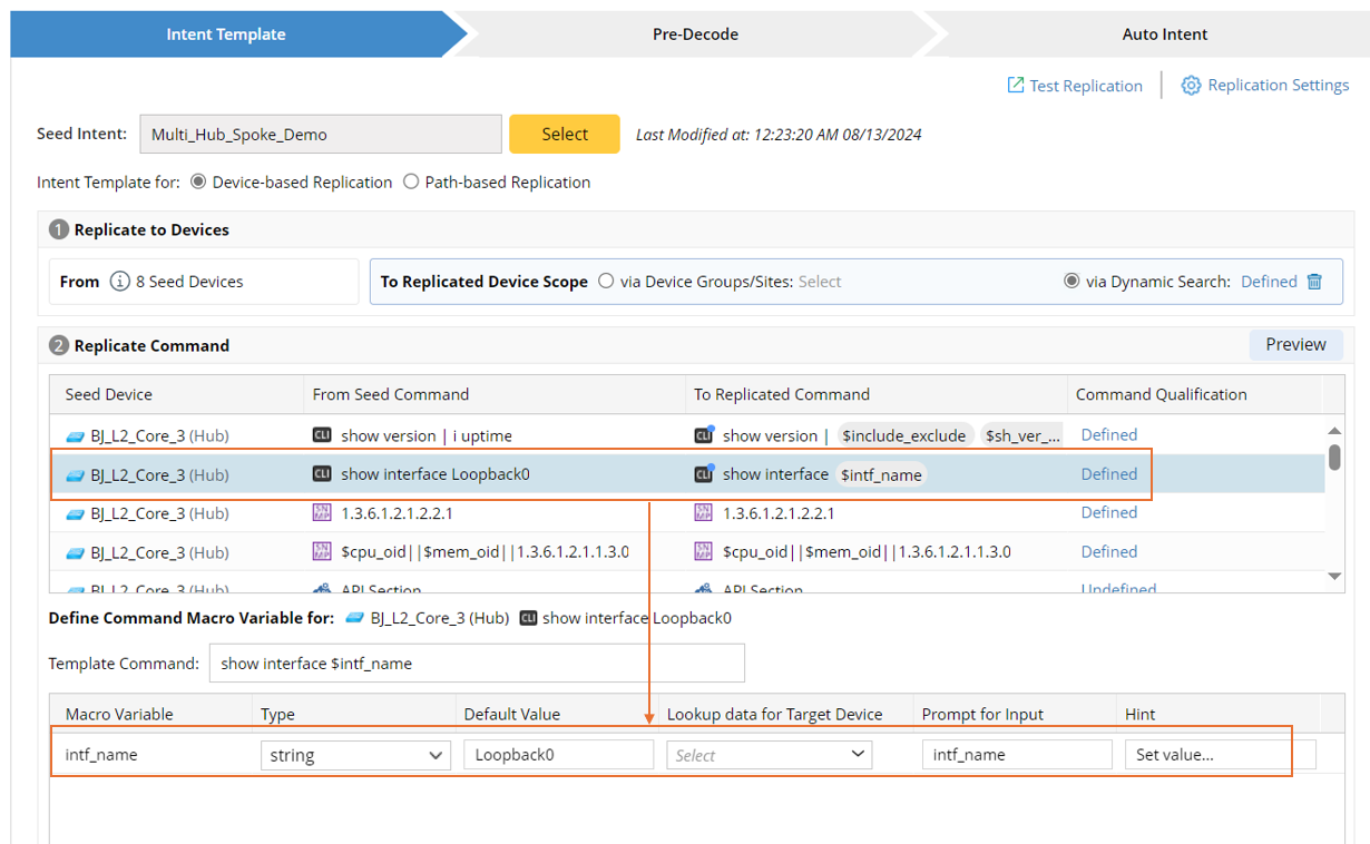

  2. Define Macro Variable: The device and the seed command with macro variables are displayed in the form of a table in the upper area of the Define Macro Variables and Rules for Their Substitution block. Select an entry from the table, then the UI for defining macro variable will display. Variable type, default value, lookup data, prompt for input, and hint can be defined here.
    • Template Command: By default, template Commands are the same as Seed CLI Commands. Changing some text that starts with “$” will automatically convert it to a macro variable.
    • Define Macro Variable: When the macro variables are displayed in the bottom area, you can define/modify the type, default value, lookup data, prompt for input, and hint. The parameters defined here are described in the table below:

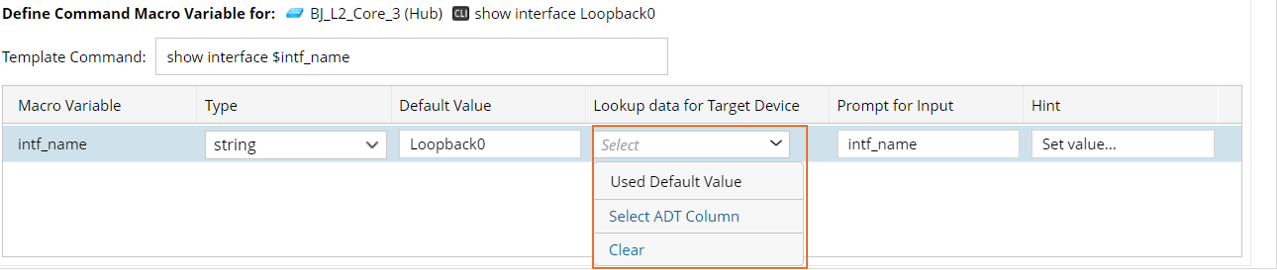

  • Lookup Data for Target Devices (when Device-based Replication is selected): Define the value bound to the macro variable for decoding devices. You can specify to use the default value or data in ADT column for intent decoding.
    • Use default value: Directly click Use Default Value from the drop-down menu of the Lookup Data for Target Device field.
    • Select ADT Column: Select variables in ADT as the target device data.

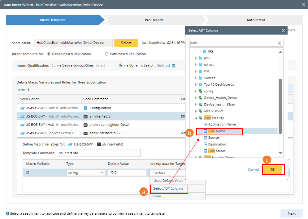

      a. Click Select ADT Column from the drop-down menu of the Lookup Data for Target Device field.
      b. Select ADT columns to use the values in the column as macro variable value.
      c. Click OK to finish the selection.

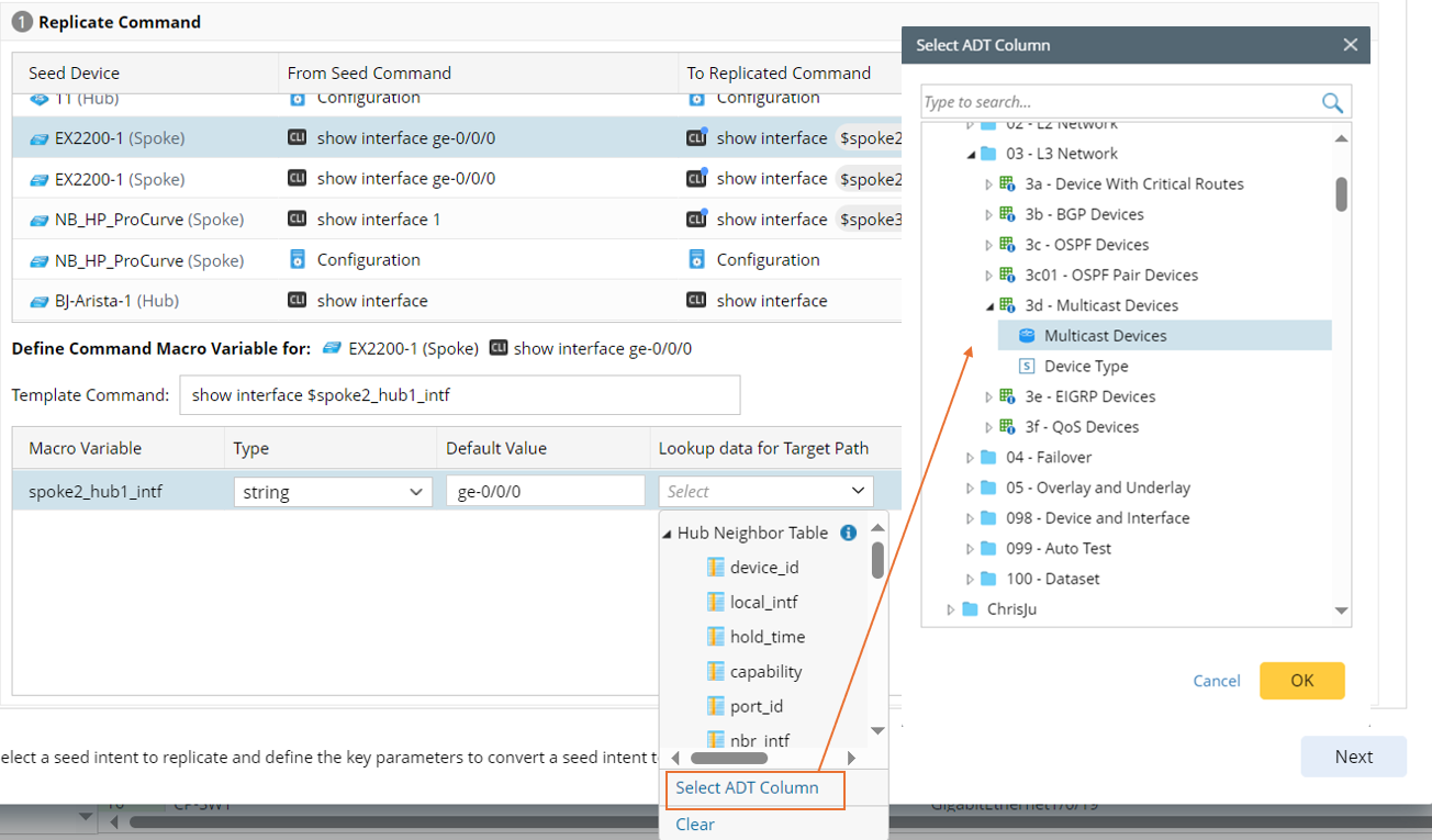

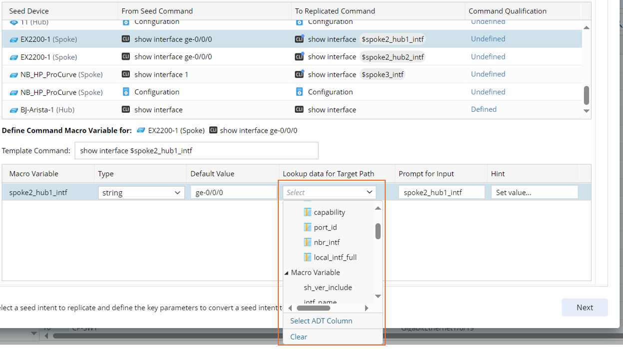

  • Lookup Data for Target Path (when Path-based Replication is selected): As shown in the screenshot below, the sources of data for macro variable include:
    • Path Variable
    • Path Device Variable
    • Data in ADT Column: Click Select ADT Column, then select ADT column from the Select ADT Column dialog box as source.

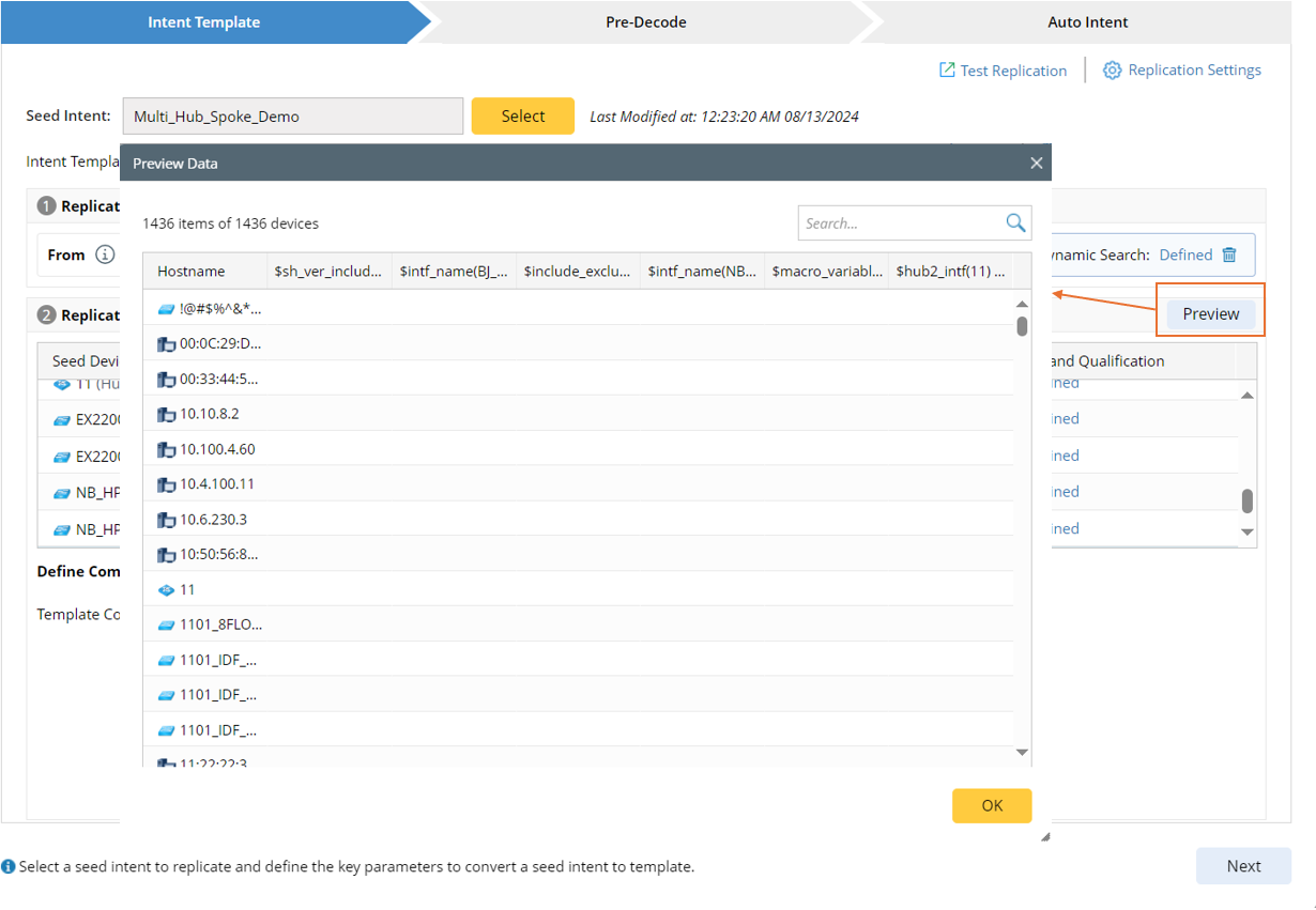

  • Preview (This functionality only applies to device-based replication): When the macro variables are bound with ADT columns, Click Preview  in the Define Macro Variables and Rules for Their Substitution block to preview the corresponding value assigned to different macro variables in all selected ADTs for different devices.
