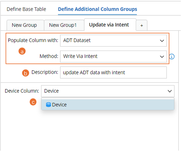

  1. Go to the Automation Data Table Builder, create a Base table, then create a new group and name it.
  2. In the left pane of the new group tab, define the following settings:
    1. Select Method to Build Group Table: Select ADT Dataset > Write Via Intent.
    2. Description: Input descriptions for the column group to describe its use and function, e.g., Update ADT data with intent.
    3. Device Column: Select a device column in the ADT to decide which data will be added to which device row based on the device information in this selected device column.

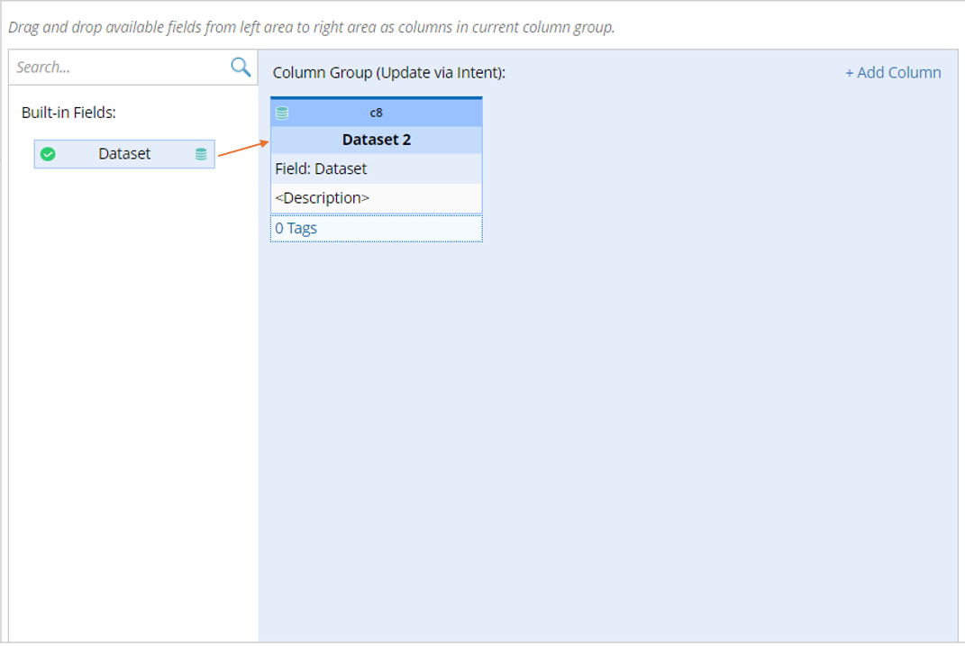

  3. Mapping available fields to Column Group: Drag and drop the available fields to the column group definition. When the dataset column is built via ADT Dataset method, the built-in field is Dataset.
  4. Click Save to save the settings for the column group.
