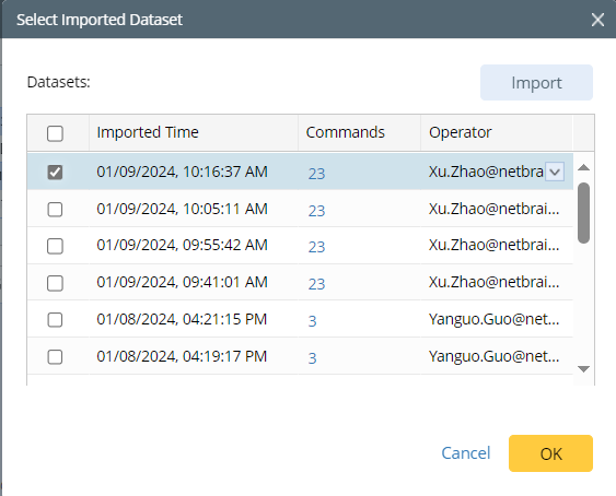

  3. Click Select adjacent to the Imported Files optionthe Select Imported Dataset window will display, then you can select an imported dataset (e.g., the dataset 01/09/2024, 10:16:37 AM).
    Alternatively, if you need to use a device command data file that is not in your domain right now, you can Import the file via the Import File Wizard. Click the Import button in the Select Imported Dataset window to start the steps of importing file via wizard. For the steps in Import File Wizard, see Define Import File Wizard.
    Information Note: The Import File Wizard that opens from the Table Builder does not support updating device model when importing commands. In addition, only the first three steps in the Import File Wizard are available.
    After successfully importing the file, the imported dataset will be added to the dataset list.
    Click OK to close the Select Imported Dataset window.

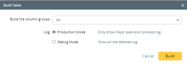

  3. Click Save and Build, the Build Table dialog will display.
  4. In the Build Table dialog, select columns groups to be built and select a log mode. Click Build
