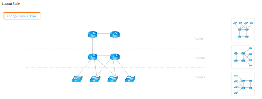

  2. Right-click the new folder and then select New Layout Style. Enter a style name My Style.
  3. In the Layout Style area, click Change Layout Type to select a layout type suitable for your three-layer network.
    Information Tip: To change the layout direction, click a thumbnail next to the selected layout type diagram.

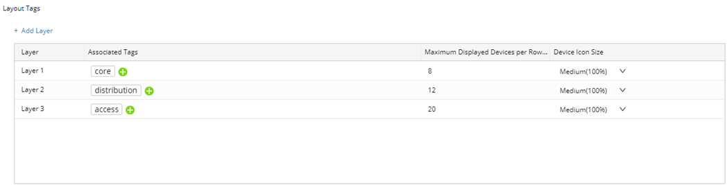

  4. In the Layout Tags area, add tags to the layout type. Tags are used to mark devices and layout layers to identify which layout layer a device belongs to.
    1. For each layer, click the icon to create a layout tag. Enter core, distribution, and access as tag names respectively. The tags will be used to associate layout layers with devices
    2. Set the maximum device number in each row of a layer and device icon size.
    3.  Click Save.
