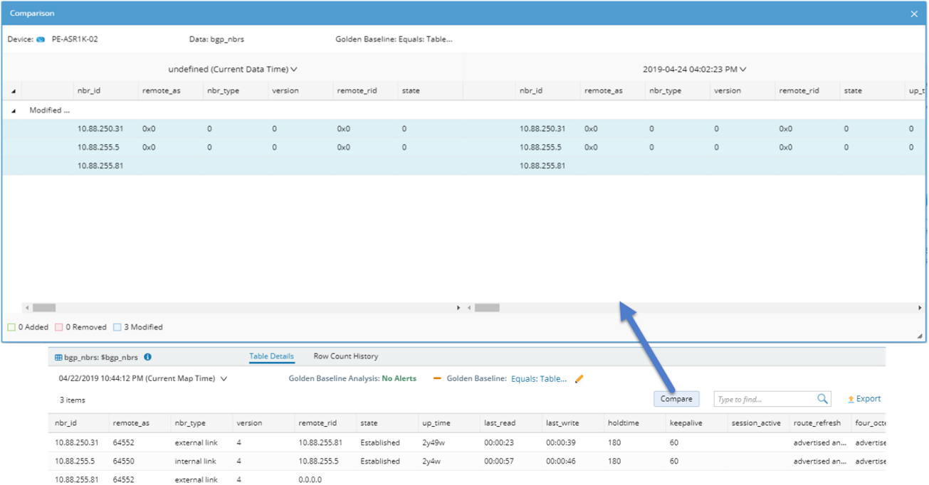

Compare Data with Golden Sample Data
Both string-type and table-type parser variables can be compared to golden sample data, a copy of data that can match the Golden Baseline Rule.
- For manually defined Golden Baselines, the data will be checked against a Golden Baseline Rule each time, so the golden sample data is the last data point that matches the Golden Baseline Rule.
- For auto-calculated Golden Baselines, the data will only be checked against Golden Baseline Rule the first time the rule is defined, so the golden sample is the first data point that matches the Golden Baseline Rule. When the Golden Baseline Rule is changed, the golden sample data will be refreshed.
Note: For table-type variables, only the table columns selected in the comparison setting of the parser definition will be compared. You can also temporarily adjust the desired table columns to view the comparison result.
