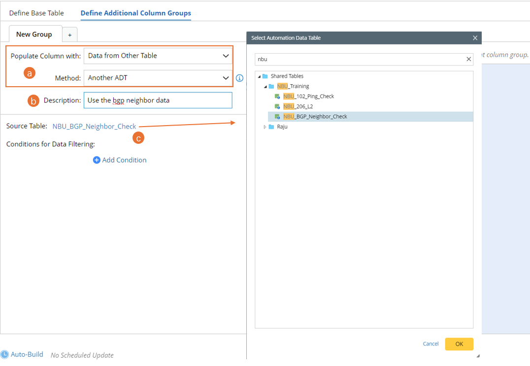

- Go to Automation Data Table, then create a new column group and name it.
- Under the Define Additional Column Group tab, define the following settings:
- Select Method to build column group: Select Data from Other Table > Another ADT.
- Description: Input descriptions for the base table to describe its use and function.
- Source Table: Click Select, then select an existing ADT for building the column group. The columns of the selected ADT will serve as built-in fields for building ADT.
