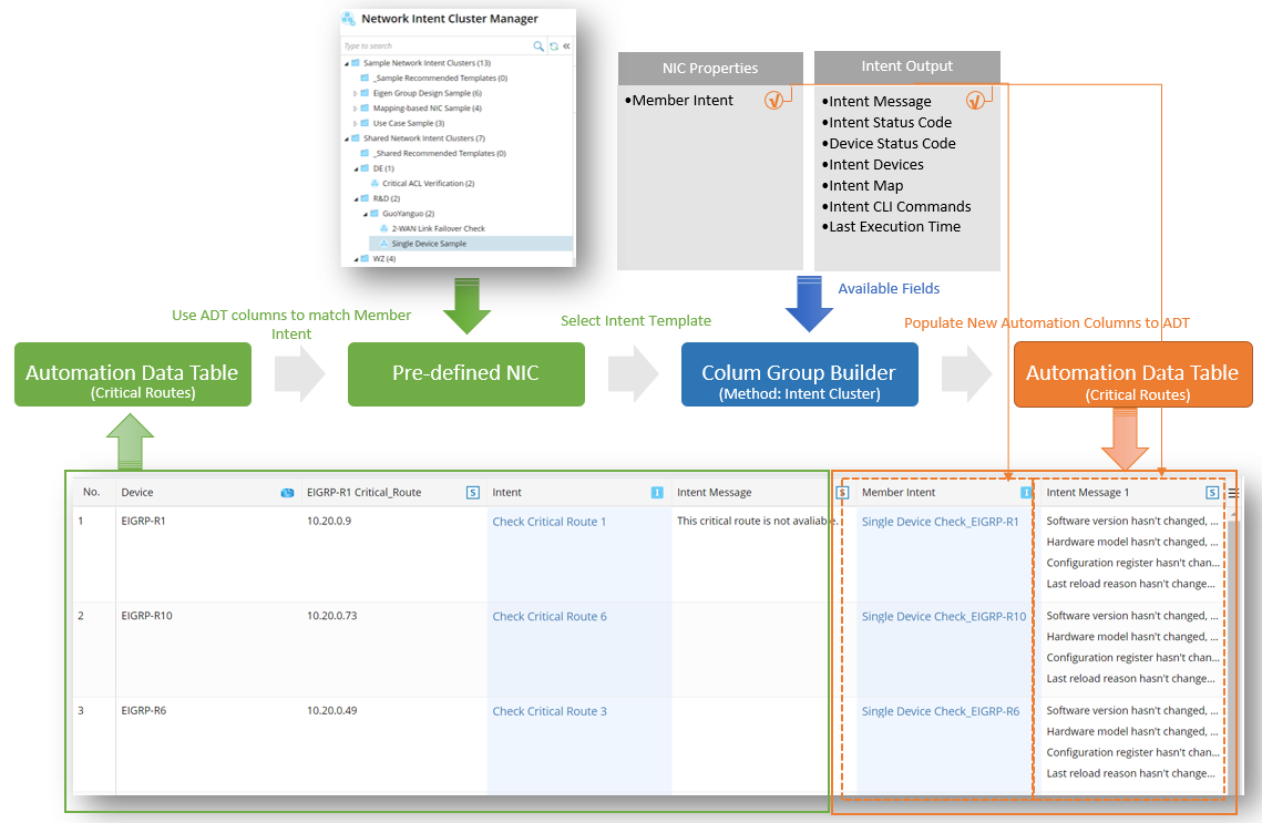

The follow diagram illustrates how Intent Cluster functions in Column Group Builder:
Graphical user interface, table  Description automatically generated with medium confidence
