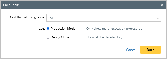

  1. Click Save and Build. The Build Table dialog appears, define the settings as per your preferences. The system will save all the settings and build the ADT data.
  2. Click Save to save all the settings. But table data will not be built.
